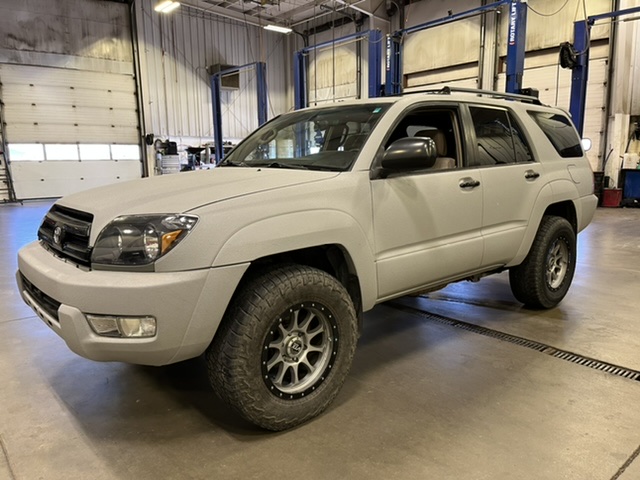

Was curious who all has raptor lined paint on the whole body. Didn’t find much in the searches but would like to see the different colors. Here is mine

I don't know of any posts with a different color...but if you don't mind saying...how much does it cost to spray the bed liner on the body?

I got the Amazon kit with the spray gun. 8 liter kit WITH color was 399…I shot it outside in the sun and it dried too quick so it came out blotchy. I ended up having to buy another 4 liters to finish

That looks good. I was initially going to go with black as well but I kept thinking the black was going to look dull and faded but it does not!
