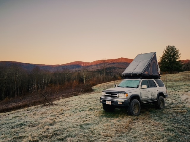

Pic of my rig for attention

Just saw the first pic of your build thread :wow:

There wasn’t much left of the original transfer case lol I never did get the full story on that from the previous owner.
