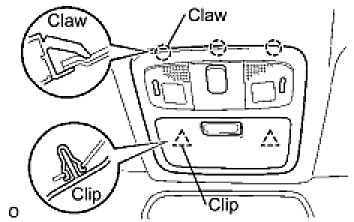

Let me preface this by saying I'm a BMW tech by trade and I ABSOLUTELY HATE diagnosing rattle noises. Most of the time I don't hear them amongst all the other rattles and noises the car makes. :hurt: Anyway......my 06 has a rattle in the headliner right at the sun glass holder. Ordinarily I do that greatest of rattle elimination steps, turn up the radio, however I can still hear this thing over the radio at a pretty good volume. The noise isn't that loud, it just seems to be right at the frequency I can hear at any time. Weird, I know. Anyone else have this noise? Kind of a taping on plastic over cracks in the road or mild jostling of the suspension. I'm sure the sun glass holder comes out but I haven't tried yet. Is it just clipped in like the center console?

Anyway, the console is easy to get off.
