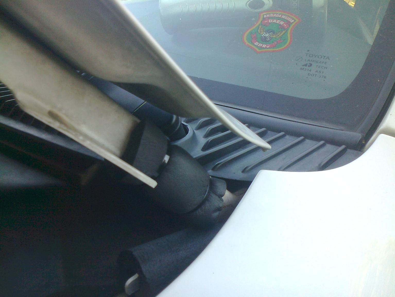

3rd Gen T4R Cabin Clunk
Last week began a noise inside the cabin to pass cobblestone street, and ripples in the pavement.
Sound of metal against metal beat. I thought to be the support of the antenna that was barely tight, but it was not .
Today I decided to research and found that when moved the engine cover near the hinges occurred a metallic noise.
So to test involved the terminals of the two hinges with a rubber hose , and went to the street with the car.
The noise disappeared ! Now I have to think of a permanent solution .
Attached photo montage .
