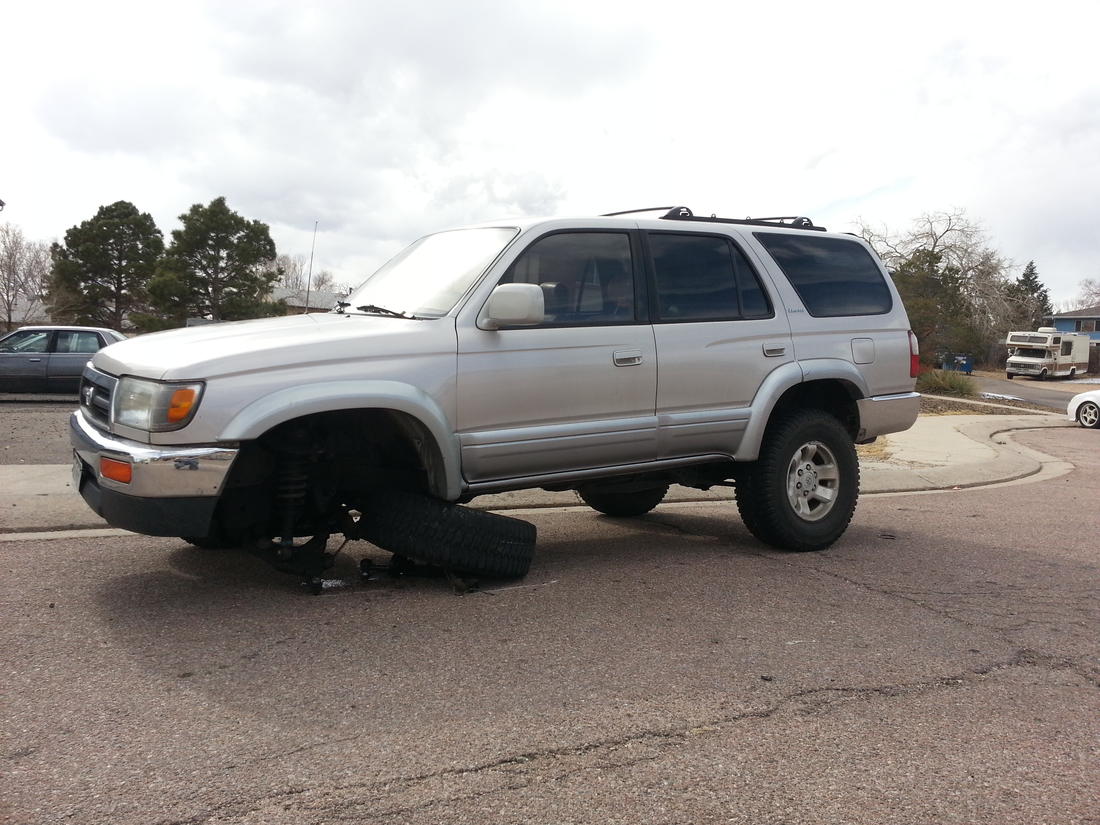

If you do this please replace your lower ball joints with OEM parts if you have not yet done it. I did the same thing. 3" front spacers cause a lot of stress up front. This happened after I ran front lift spacers for about a year.
