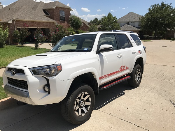

Nice sliders. 50lbs driver side and 60 lbs passenger side. Now if I can figure out how to attach a pic.
I have a Toytech BOSS lift (Tandem Automotive in Haltom City, TX, highly recommended especially if you have KDSS) with factory tires as I have seen some threads where people are asking what it looks like. Not too bad, it is just that the stock Bridgestones are ugly. I do plan on new tires and wheels next year. With the lift the front wheels come in too much and I don't want to use spacers.

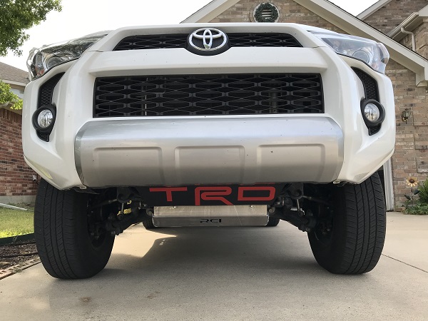

RCI Skid Plate
I also installed the front RCI aluminum skid plate and the black metal spacer between the bumper and the skid plate (replaces the black plastic spacer from the factory).
I got the red TRD decal that goes on the TRD Pro skid plate and managed to make it work here by putting it on the black spacer. Wasn't easy to install but managed. I like it. Got the decal from https://tvdvinyldecals.com/
