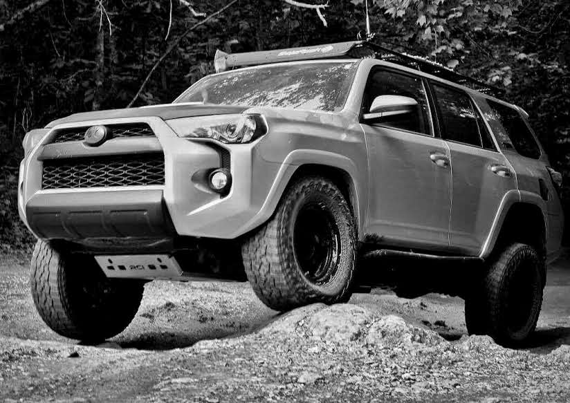

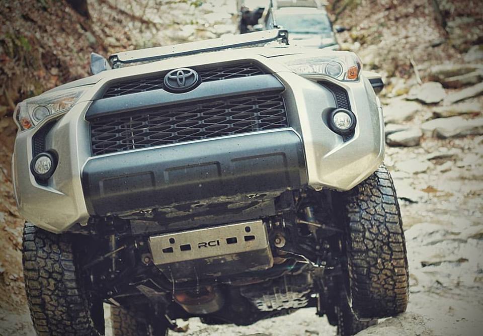

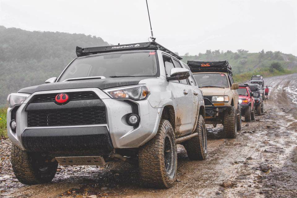

Anyone have any pictures of their 5th gen with the bare aluminum (especially a silver 5th gen) or pictures of a bare aluminum that they have had for a while to see the corrosion?
Thanks
Thanks
Corrosion = none
but scratches, gouges, and dents yes.

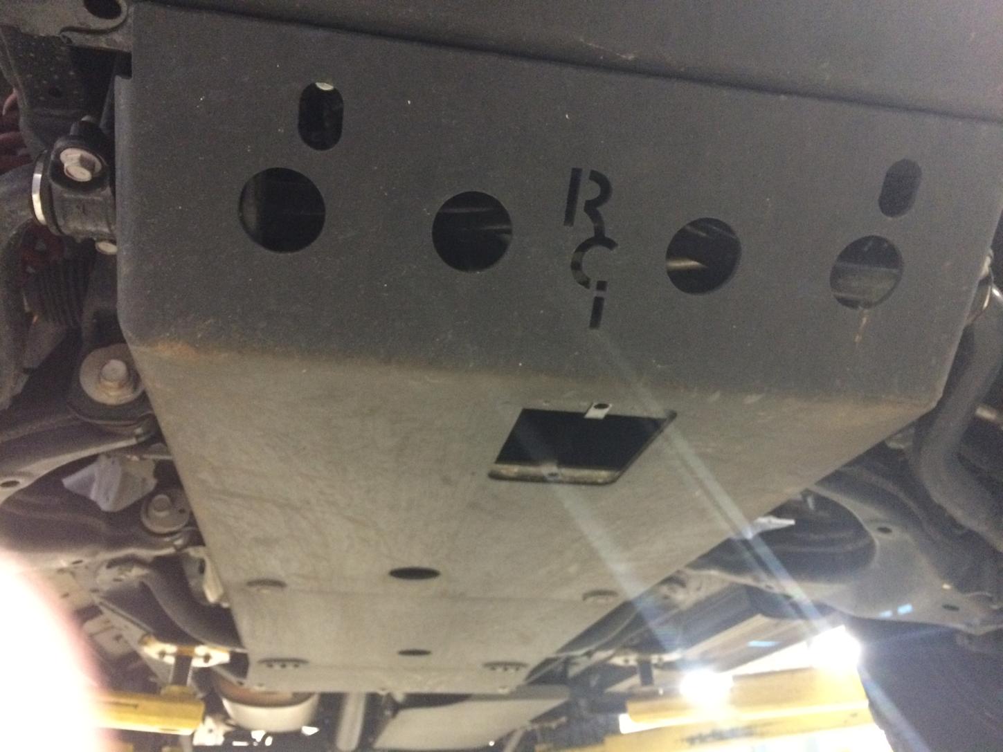

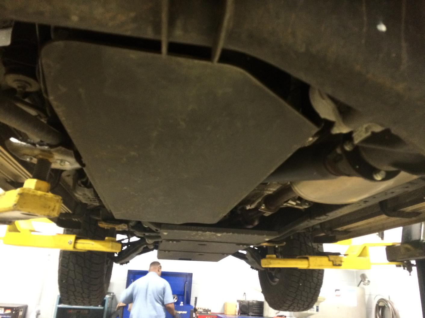

I have steel RCI skids on my 4R. They have held up great. We don't get much snow but we do see plenty of water and humidity. That isn't rust on my skids, that's mud and dirt.
