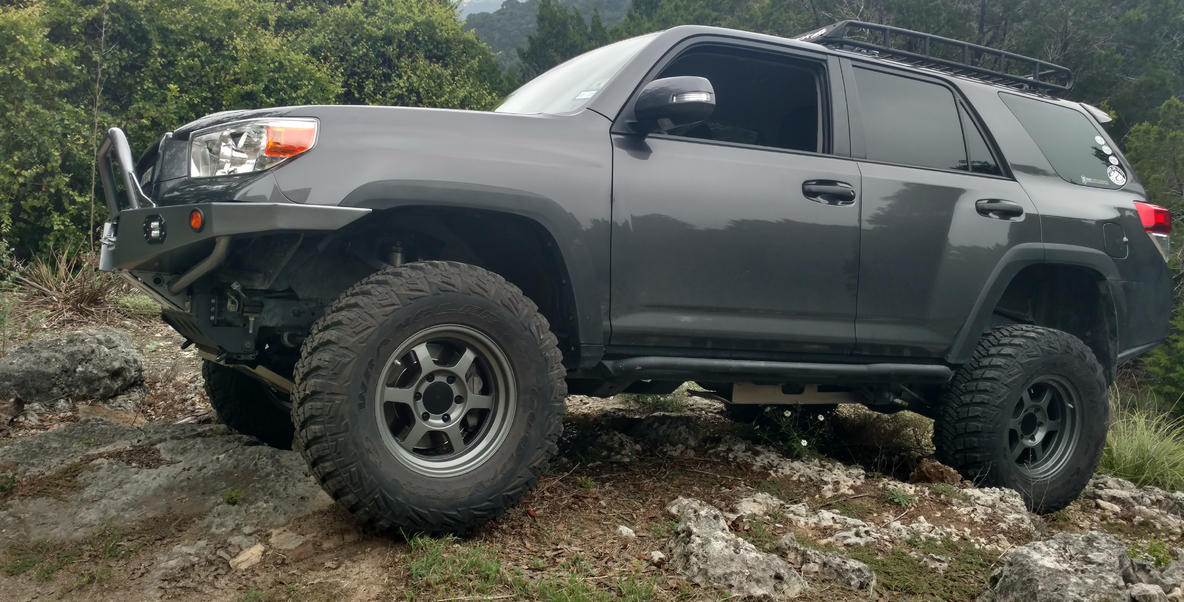

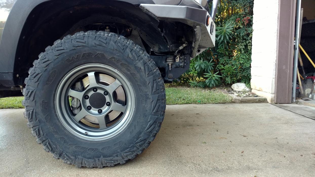

Maybe I forgot what it is like to have stock tires... but here is a side view of my truck with the RCI skid (the one that rest up against the radiator support brackets - which I like since they are very strong...). You can see the aluminum skid in the first pic. The second is a side on shot. Notice the tires are way in front of it. I still hit it when a ledge has a point.. and I pick a bad line... but generally speaking it is the least of my clearance issues. And I wheel the crap out of my truck I often hit the front town hooks more often than the skid...
