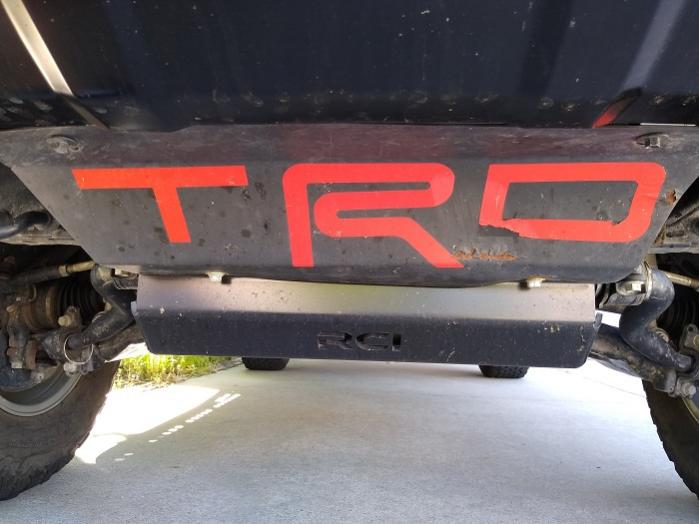

I got one and even put on the TRD red letters that are made for the TRD Pro skid. Looked good until I hit a tree stump on a 4x4 road. It bent but it actually did provide some protection.
Also I rattled canned the edge of my aluminum skid. Aluminum just got too much of a whip to clean every so often with aluminum cleaner.

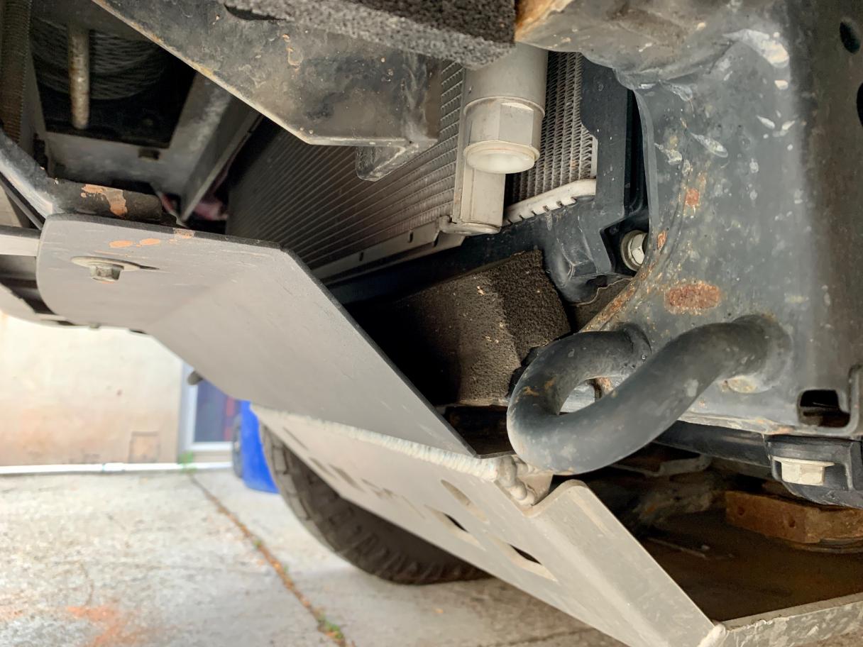

It actually helps protect your, ugh... plastic, radiator and A/C condenser from debris, either flung up or driven in to. Its like 14 or 16 guage steel, decent for brush small limbs. ect.
