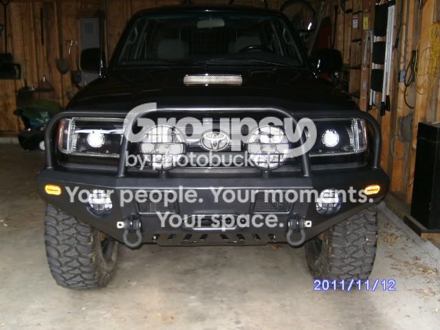

Anyone find any or do they have to be custom made? its stupid, I can find them for every year except 3rd gens.... anyone have any insight?
I did a Morimoto D2S projector retrofit that I purchased from Matt from theretrofitsource.com - It's pretty easy to do on the big 4Runner glass headlamps that are easy to remove from the car without even having to take bumper off. Getting the horizontal alignment took me the longest amount of time because I wanted it perfect.
Click here for my retrofit
I purchased this kit: Bi-xenon Morimoto Mini Stage III Kit (H1) from The Retrofit Source Inc.
Here is my retrofit thread:
http://www.toyota-4runner.org/3rd-gen-t4rs/101725-bandit-runners-projector-headlights.html
And a pic:
PICT1185.jpg~original
