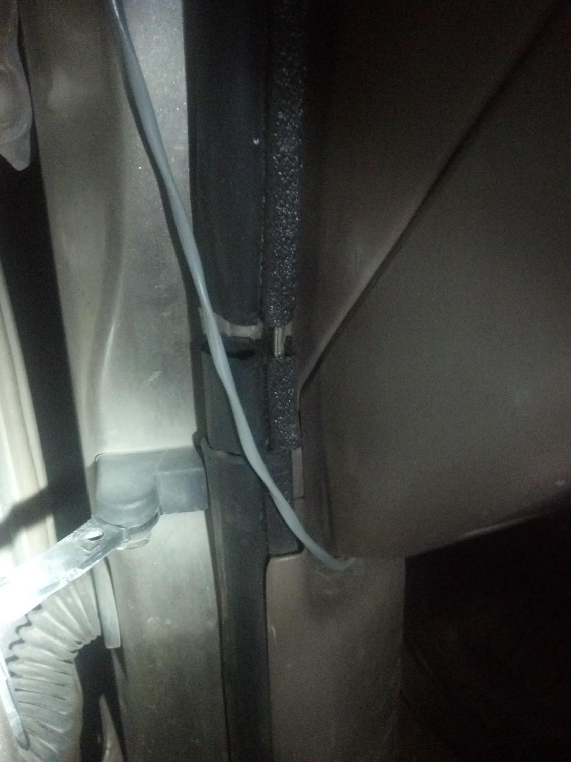

my dad used to take my 4runner on long road trips, the weather strips will eventually shrink, what he found was that you cut the loop at the front of the door jamb and add in more pieces of stripping, then move the stripping around so it fits back, its highly effective and its cheap, if your weather stripping has holes in it though you might want to replace it.

^ last two posts...thanks...I think I can get them back in order using some extra weather stripping and that adhesive you posted...Nice!
