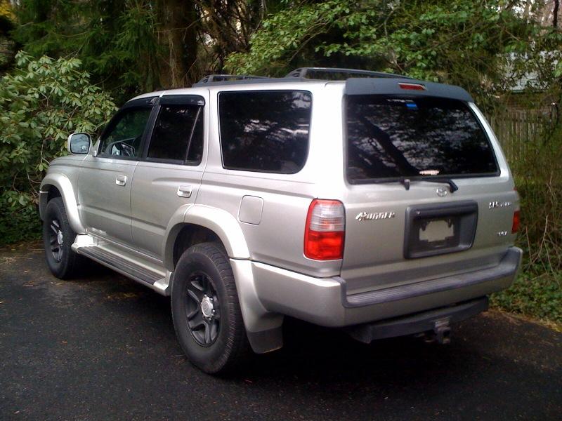

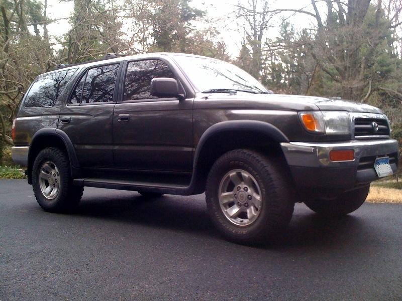

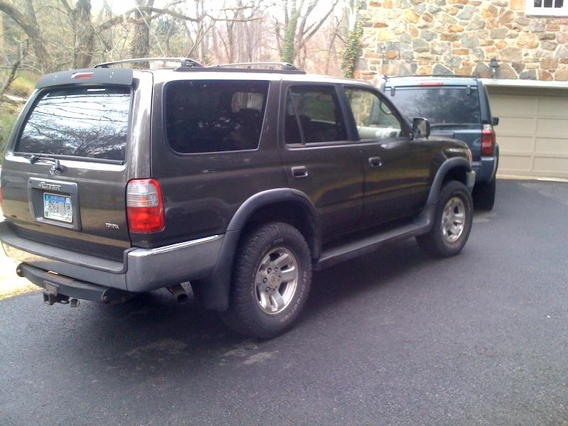

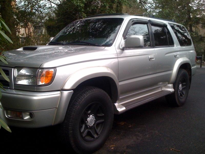

I wanted to post some pics of old and new one. 98 is charcoal and 2000 is silver.
