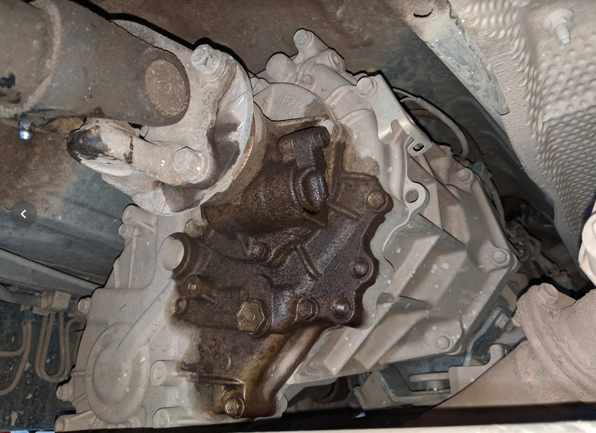

The 5th gen speedo is actually completely driven by the abs wheel speed sensors, so overall tire diameter is the only thing that will affect speedo, gearing doesn't matter.
The spot where the speedo sender was in the VF2A transfer case is just a blank cover now. You can see mine where the O ring sealing the cover caused an oil leak. (single bolt pointing to the passenger side)
