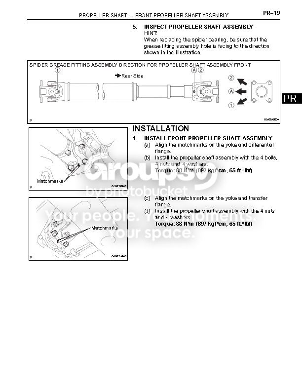

For 4th Gen 4WD 4Runners, has anyone re-torqued propeller shaft bolt as recommended in the Scheduled Maintenance Guide? Are these the same one which requires the lubrication?
What are the torque numbers for these bolts?

This is for the front shaft but they are all the same.

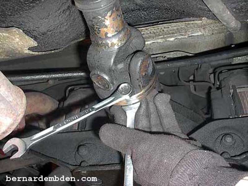

Resurrecting this thread with a question: got a 14mm socket onto these bolts but the driveshaft rotates when you try to tighten them. For anyone who's done this, how did you block it from turning?
Thanks. A lift obviously makes this job much easier. I’ll jack mine up and see if I can get enough space. Locking it with 4WD will be Plan B as being able to rotate the shaft makes it much easier to get a wrench on each bolt.
