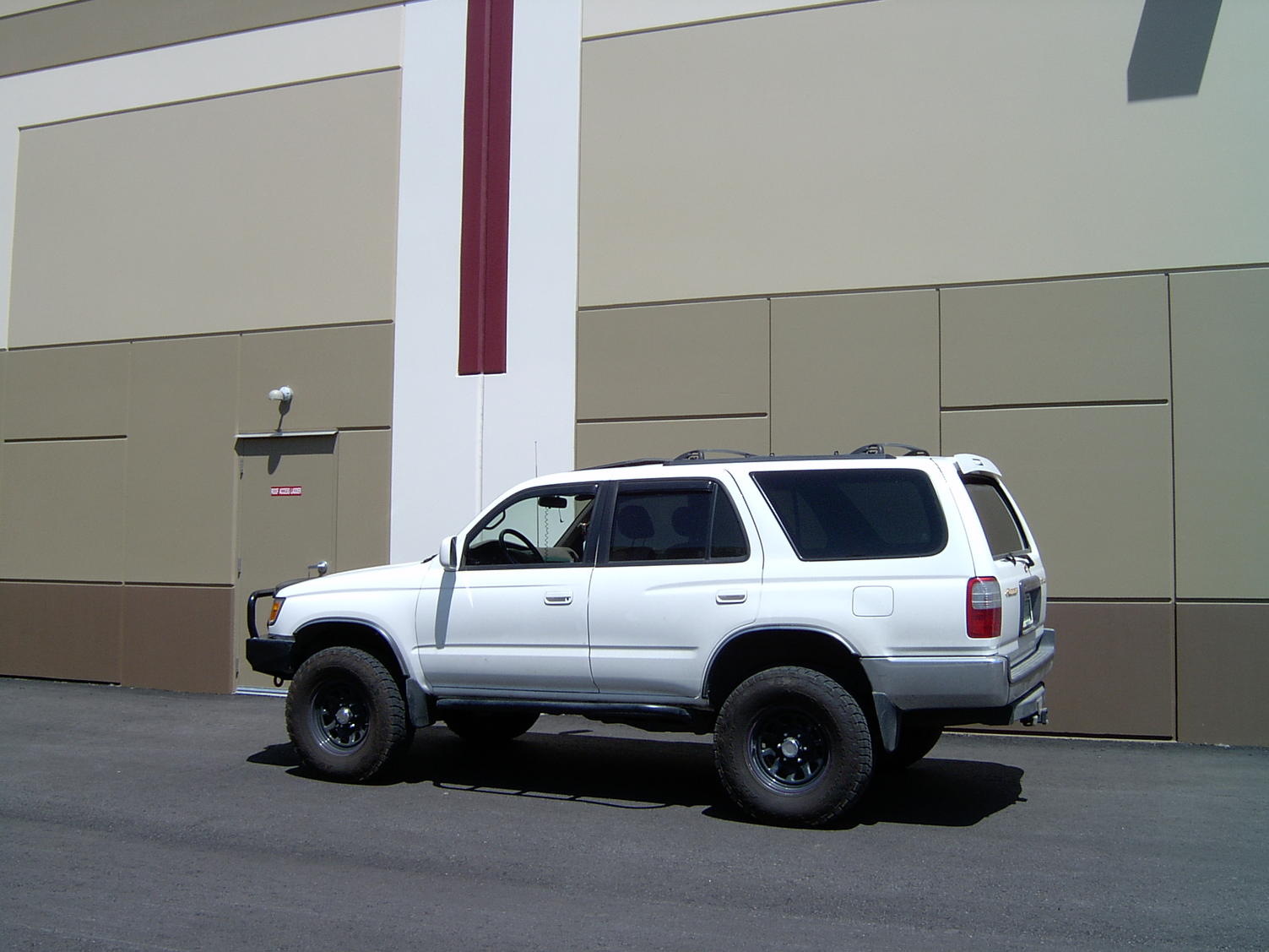

Politely I will say that the 891s will be too stiff. I had 891s and loved em for a bit, but soon every pothole grew tedious. If you run with 500 lbs all the time in the butt end, they will be great. If you do not- they get too jouncy again subject to my tastes. My 891s rode great when I had a load of gravel in the back-and that was one of the factors when I got them. But I haul gravel only a few days each year to replenish my driveway.
The 890 is a good compromise spring for the back end. My rake is not as severe as it was with the 891s. When I load the 890s with 500 lbs of gravel they still ride fine, but they do set down a bit lower than the 891s did.
Others run the 891s all the time and love them. Everyone's butt feel behind the wheel is a bit different.
Just telling you of my experience with them. I was quite fortunate that fellow member CSL wanted to move up from 890s and took my 891s and gave me his 890s. Then eventually he went to Landcruiser springs for his butt end.
If you are looking for good lift, some rake, and good ride I would point you to L/C springs which I believe come in 8 and 9 wrap variations and are not that difficult to find.
Read up on the Sonoran Steel website for more info on OME springs.
Picture is when my lift was first installed with 881s and 891s. I did like the stinkbug look and now I sit more level with the 890s in back.
