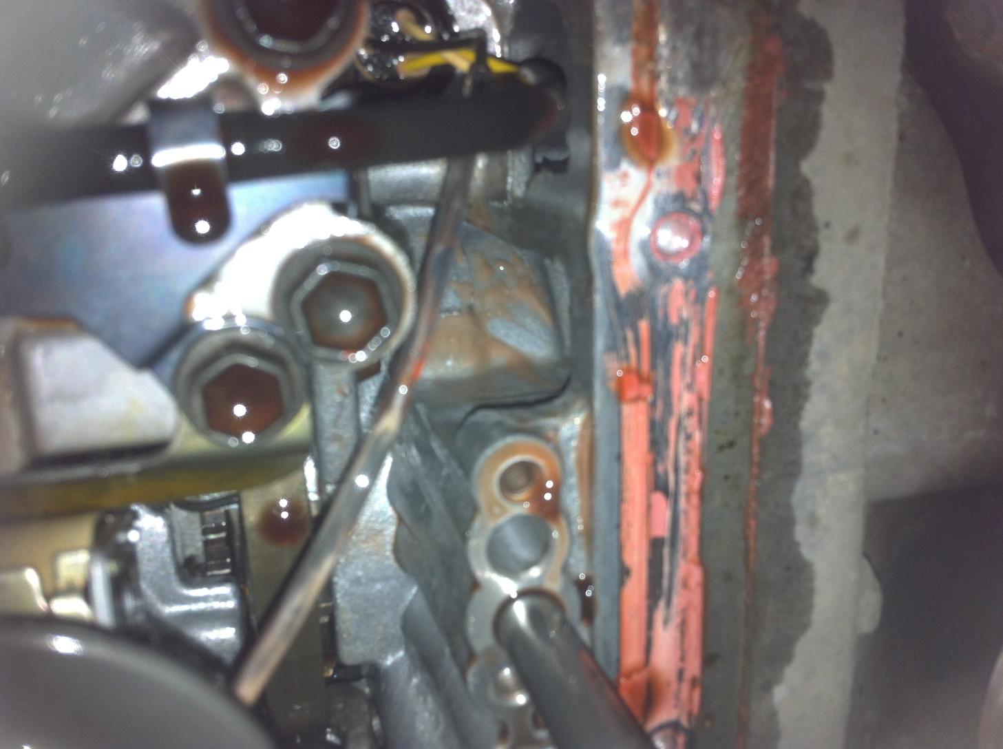

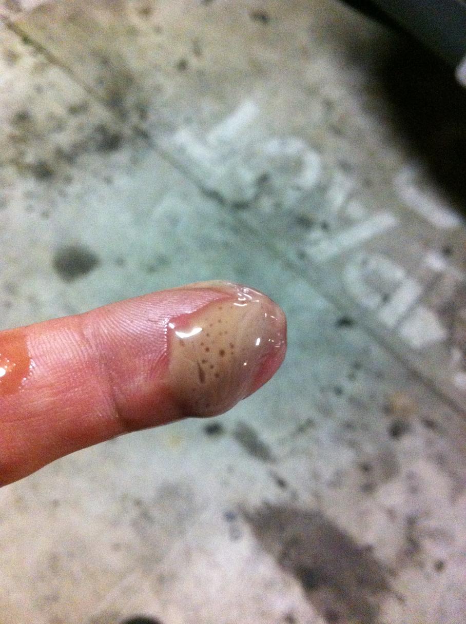

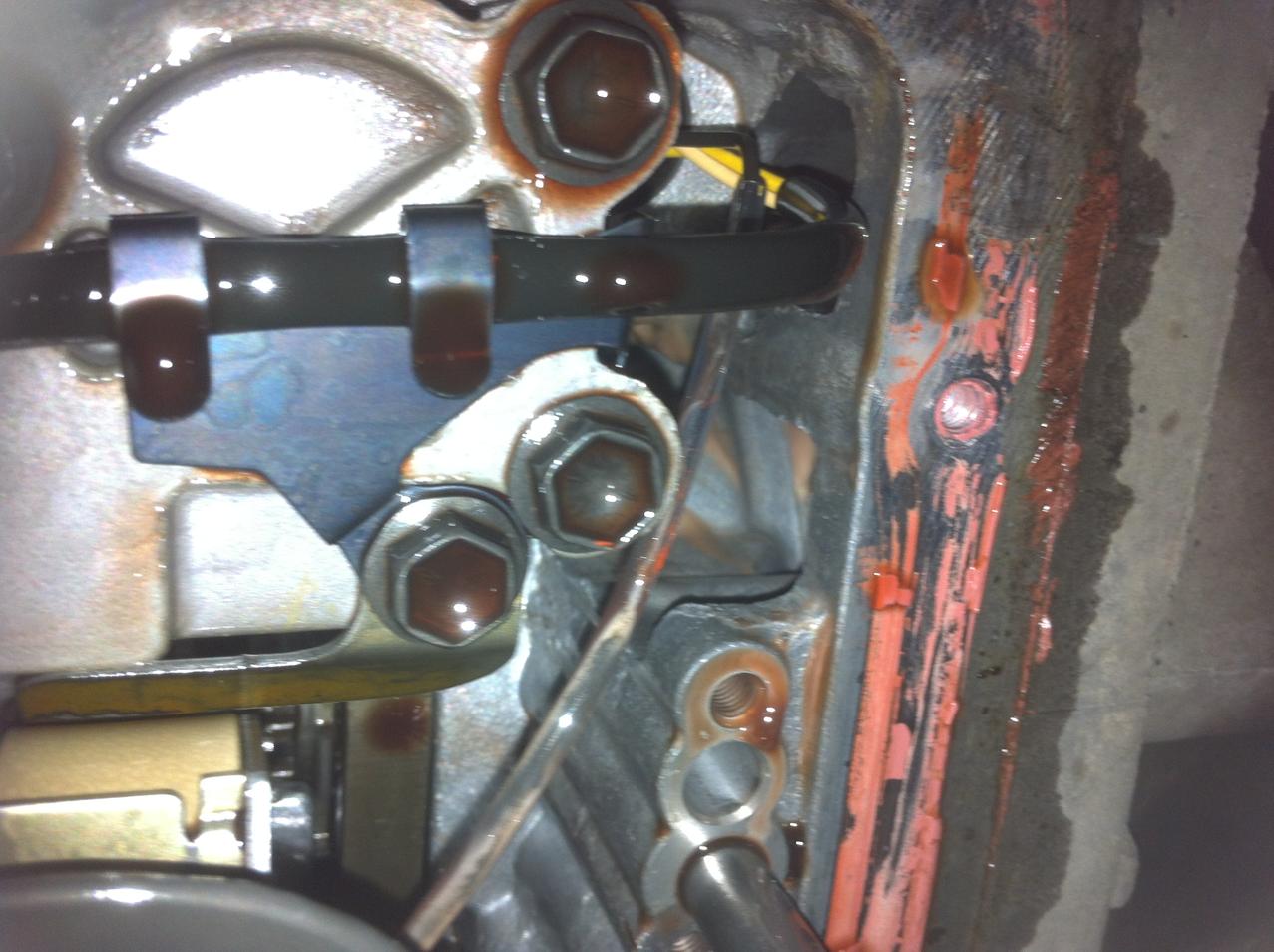

here are some pics. You can see the color of the fluid on the bottom of the bolts. The stuff on my finger I had to reach up in to get. You can see it in the other pics as well.

Looks like the dreaded pink mikshake to me, fluid looks awfully frothy on your finger. Stop wasting your money on simple fixes, and a flush won't help now. Its either time to source a new or used tranny or rebuild what you've got.
