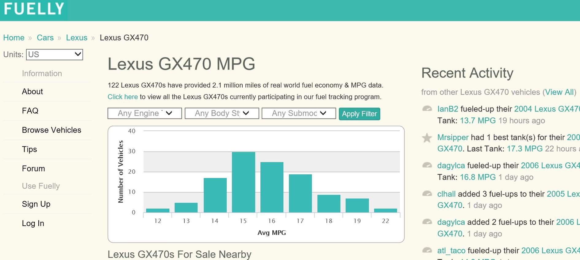

fuelly
Fuelly shows for the most part hand-calculated mpg
It looks to me like the very last couple of years were getting a hair better mpg

also a question for you owners: when I go through fuelly.com's list of GX 470's, it seems pretty clear that the late models were reporting a tad higher mileage than earlier ones. Did the mapping get better for, say, 07 to 09? or maybe the luck of the draw most of the reportees may be just grabbing groceries and running quiet low-stress tires...
