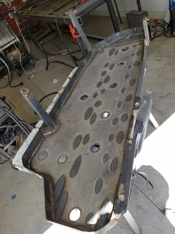

Third vehicle prep item was the transfer case skid. I'm on my third one. This year I ran with a locally made aluminum one. Worked well. I'll try to find some pics. I did bend it - and took it off just to press it flat again where I get a slight vibration from the exhaust in reverse. Otherwise i'm happy with it. Fits very tight, which I like. But it also means very close to the exhaust. My general approach is minimalist, reduce weight, and gain clearance from tight fitting parts as much as possible.

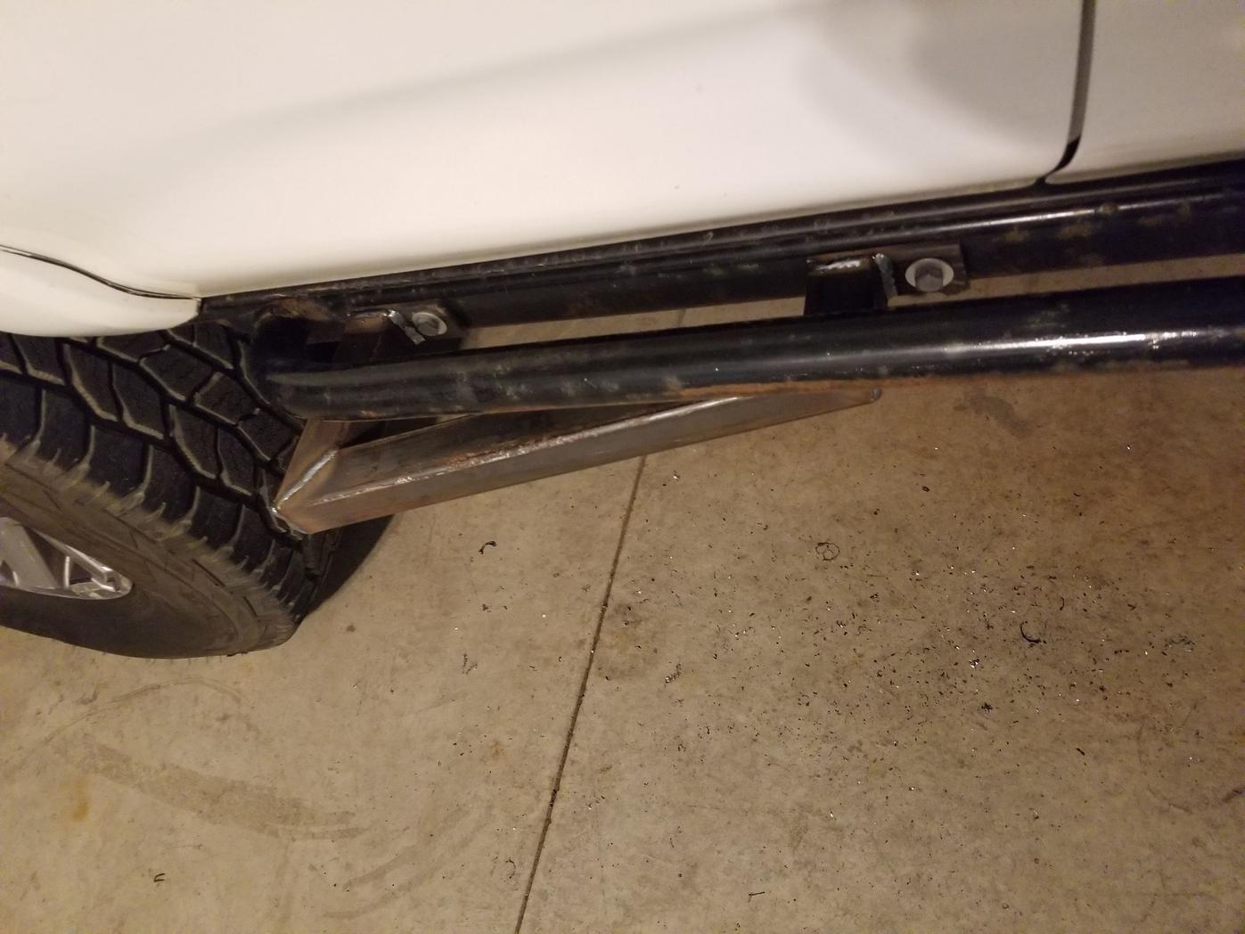

The sixth change was the sliders. I ran out of time as the trip came up, so I made some very quick and dirty kick outs for my very tight fitting sliders. They were just the ticket for keeping the rear fenders off the rocks. I would not go there without them if possible. Kick outs were a life saver a few times. I like the minimalist look for normal daily driving. As crude as they were, they worked perfect and I may just keep them. I didn't even have time to paint them.

very cool writeup and photos! thanks for posting. any closeups of your added kickouts? I run straight sliders too, as I haven't encountered a situation where I've needed the kickout, but I can see from one of your photos where you probably used it. did you ever find it bumped you into trouble on the other side unexpectedly?
Great pics and great write up! Lol on Coopers. I have been running them for eight years now. Great all around tire.
Thanks. Here's a better picture. I will probably bend a new set of outer hoops for the sliders. Just ran out of time. I literally made them at 10pm the night before I left. I'm kinda embarrassed to show them up close.
I didn't find any instance where they pushed me into an obstacle on the other side. I was also worried about it. But they're just barely wider than he rear tire. A couple spots last year I was almost into the fender on rocks and had to either take another attempt or jack the rear away from the rock were much easier this year.
