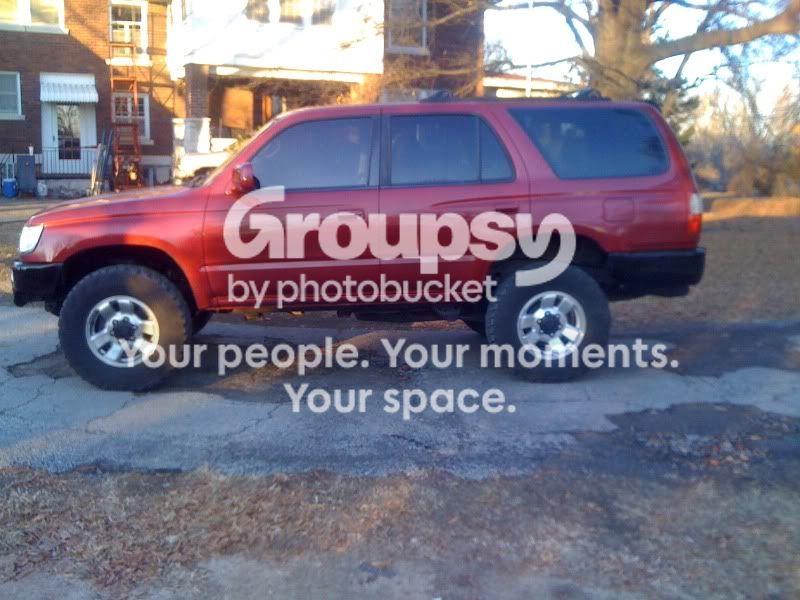

Shocks and springs in rear were so bad and had a free day figured we'd get the rear on, and worry about the front next week sometime.
Started out with 29 1/2" from ground to fender....afterwards went up to 33".
Before:

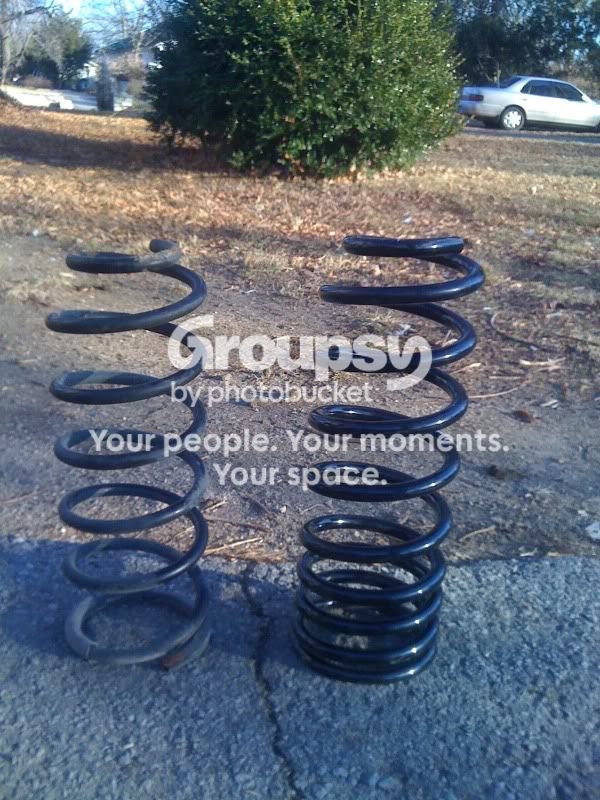

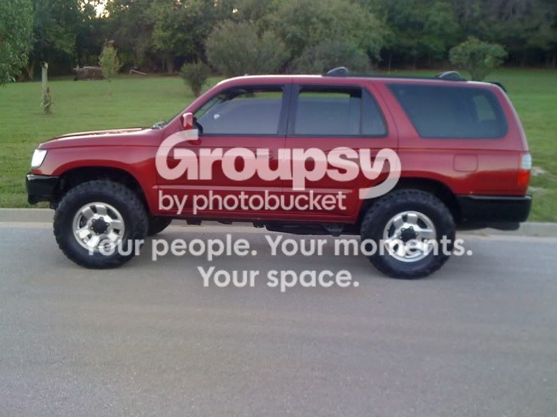

After:
e04b3bd1.jpg~original
f03a91d8.jpg~original
84e7ccc9.jpg~original
8ca48384.jpg~original

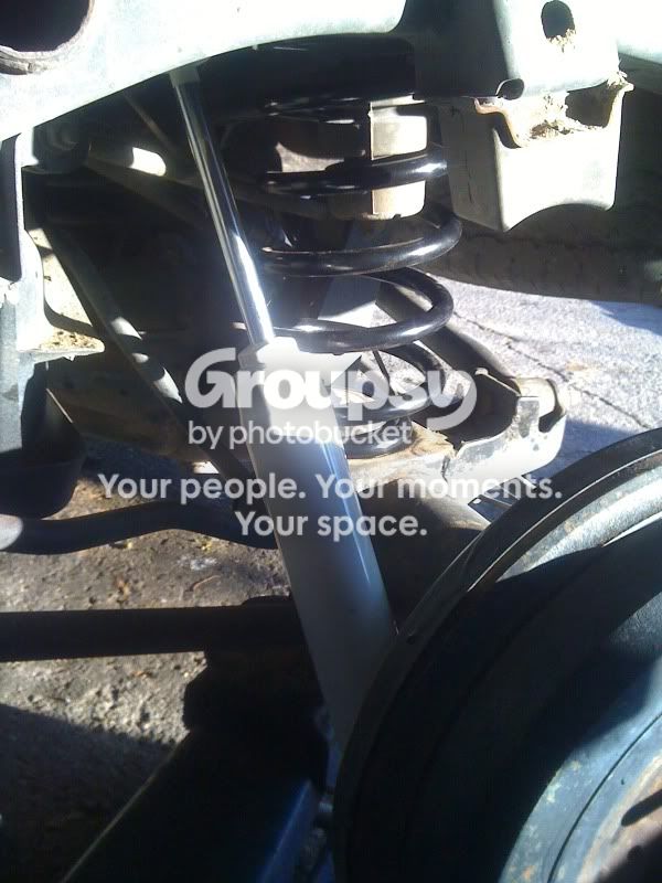

Rancho RS5000 (RS5158) shocks fit great will go with the 881/Tokicos up front.
Also for anybody who says it's too firm or rough, you're crazy cause these things are nice and smooth compared to stock, and decrease body roll by a lot.

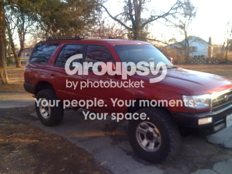

Hmm that's weird. I'll re-measure tomorrow...actually I went from where the bumper ends flare back. I will get a different one tomorrow. Just realized we measured differently. I also will be getting a trac/panhard bar. Passenger side tire sticks out farther from fenders than it does on driver.
Hope to get 881's with those tokicos next week. Should take about an hour to stick them bad boys in and align it. Took about 1:15 to get all rear done. Just couldn't hold out any longer with the rear the way it was riding.
