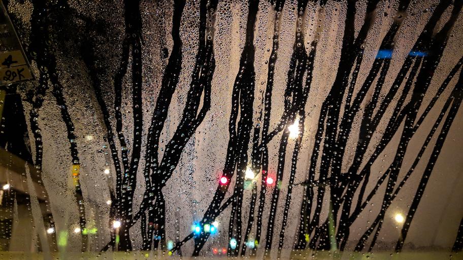

I got better results today on the front windshield. But I did notice significant condensation and was wondering if this is normal. The rear defogger works: starts from the top center and the spreads downward but the left and right middle to bottom part of the rear window are weak and do not clear completely. I do have an aftermarket tint and wondering if that could be an issue. The picture is of the condensation on the front windshield which is on the inside.

if you have that much moisture on the inside of your window it probably means you have a leak somewhere. check all the carpets and see if any are wet, you've probably got water inside the vehicle somewhere
