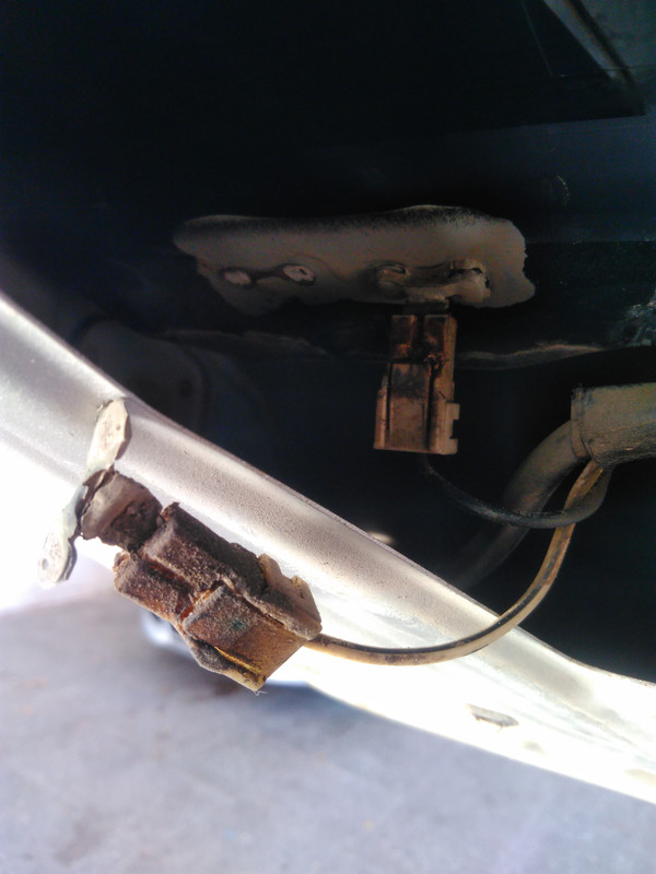

Talking about these tabs. They are glued and fixed now
These two wires shoud be positive and negative, right ? If one of them is broken, multimeter should not show any voltage between them, when switch is on
