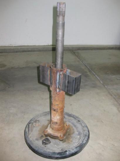

I have a spare housing that you can cut and create you own SST. It will look something like this.
