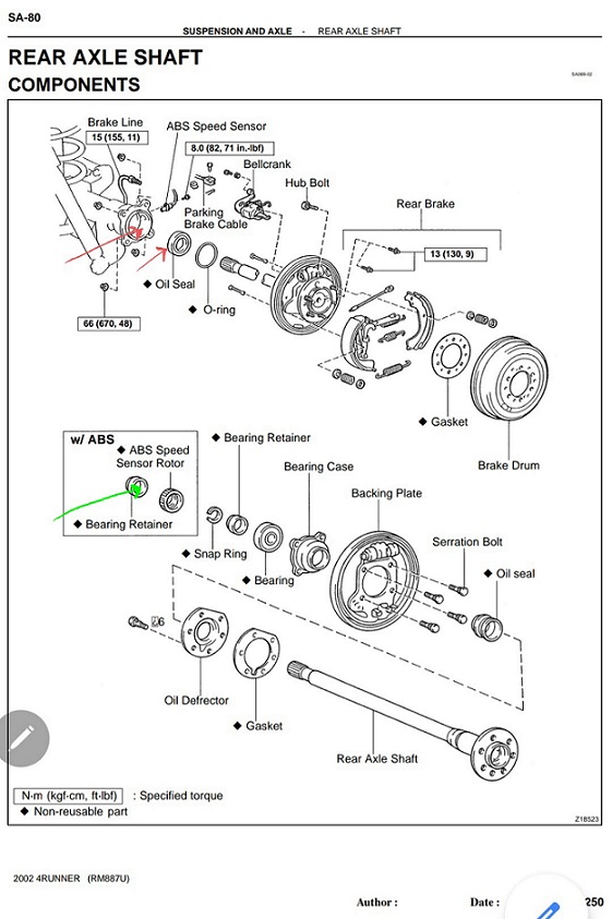

Revisiting this because I found out this weekend that the driver side rear axle seal on my friends 3rd gen was leaking. We changed both sides about 4 years ago.
Want to make sure I understand the this correctly:
1. For those that suggested using FIPG to seal the mating surfaces of the seal & axle housing (red arrow) and the inner diameter of the inboard retainer where it contacts the axle (green arrow), are the arrows pointing to the correct locations you were referring too?
2. Is the green arrow the inner retainer that was suggested to be replaced?

1) Arrows are in the correct place.
(For those that may not be able to see the diagram the location is the outer portion of the axle seal and the corresponding area of the axle tube where that seal would install. For the inner retainer, furthest from the hub and closest to the axle splines, I would apply the FIPG to the inside of the retainer as well as the polished portion if the axle shaft after installing the bearing, outer retainer, and ABS ring. After inner retainer installation and proper placement is verified I would also apply/smear a bead of FIPG where the retainer and axle shaft meet on the inboard side of it.)
2. Green arrow is pointing at the correct retainer. (For those that can not see the diagram it is the inboard retainer closest to the axle splines and furthest from the hub.)
Thanks! Will likely do all of the above.
