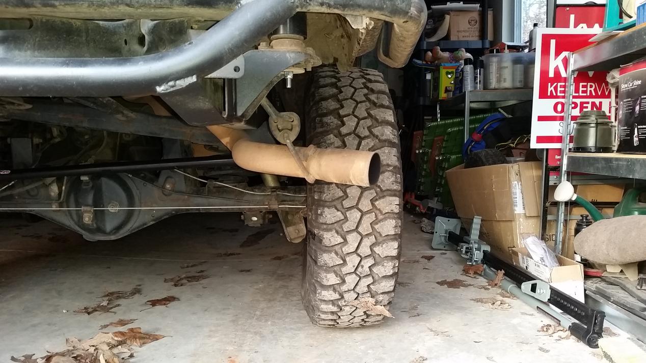

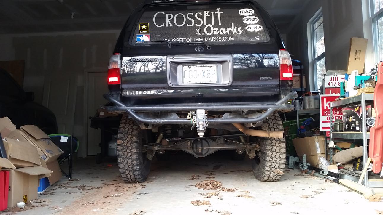

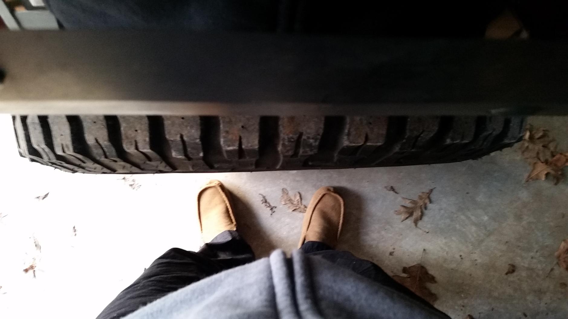

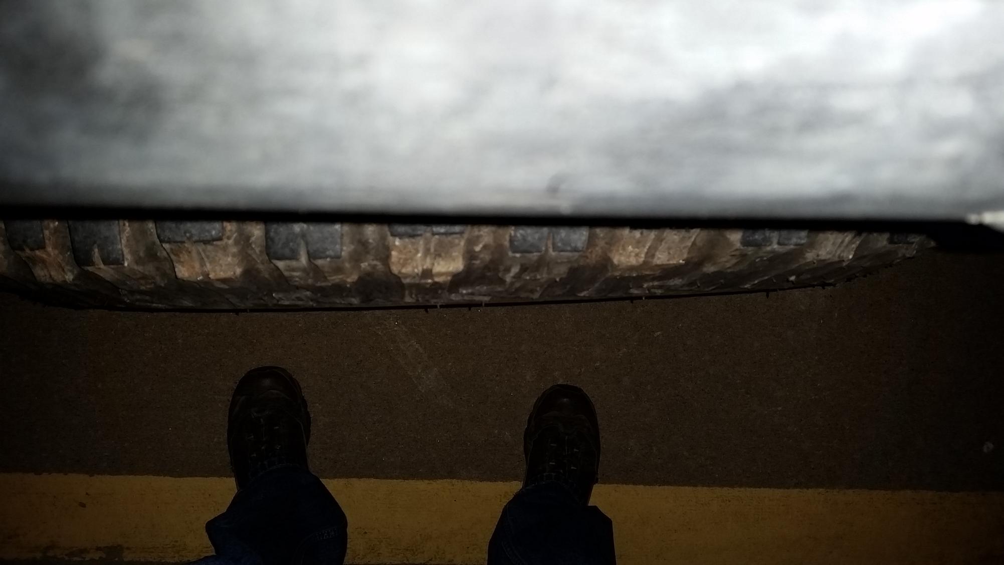

Some Pics
Just took these.

More
Took one last night and one this morning. This morning I backed it up in a parking lot and the tire was kicked out. Yeah, I'd say axle is bent. I guess I just need to get a new axle housing. Best place to get one? There is a 99 at Pick N Pull in town I'm gonna go check out today. I guess it really doesn't matter if I find an axle with the E-Locker or not. Mine has the rear diff lock but I reckon either housing will work.

Well, the axle was bent. The last 8 inches or so before the hub was the bend. SOOOooooo...I replaced the axle. Went to salvage yard, found an axle that matched mine, dropped it, dropped mine and installed the new one. We're good to go now. Best part? I paid $110 for the complete axle minus elocker motor. Thanks for your help folks!!
