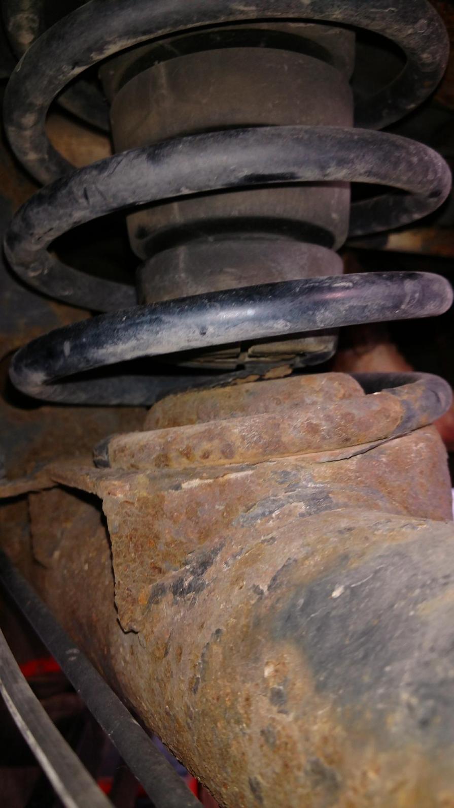

Feels like my rear end is bottoming out on 2000 4runner going over bumps. Recently replaced rear shocks figuring that would improve but doesn't seem like much improvement. Other ideas? Need new coil springs? Pic enclosed of rear spring. Should there be more clearance for the enclosed bumper? Truck seems level looking at it from the side.

Looks like it to me. Ive had airbags for like 5 years, so i can't compare mine but you have like no travel it seems.
If your fine with your height a cheap fix would be to cut off the bottom of the bump stop but idk how bottomed out your shocks are.
Might need to replace the coils. Bump stops look wayyyyyyy to close to the axle. Good sign of worn coils. Shocks don’t hd the weight. The coils due.
That cone bumper is very soft (not the frame bumper that is hard), but you will still feel it engaging over bumps.
Measure the center of the hub to the fender lip - I bet you are down around 19" or maybe even below. Your front might also be hitting the bump stops with some regularity.
New OE springs all around are your best bet unless you want a lift. (new springs will just get you back to stock height of around 20" hub to fender)

You should definitely have more space than that. It should be 3-4". If money is tight, you can get the Moog springs.
Your coils are toast!
Adding new shocks may have helped the ride quality a little, but it'll do nothing for the ride height.
18.5" on front, 18" on back... guess it is squatting! I guess I will do autozone coils for $60 on back, $90 on front with lifetime warranty. Figure I will keep the truck a while so maybe in another 15 years, I will do em again for free?
