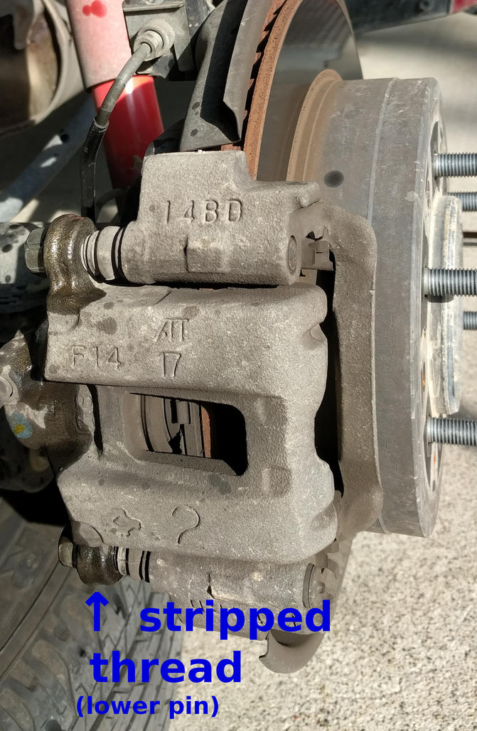

2015 4runner stripped (rear) caliper pin
Hi!
I just stripped a caliper pin thread (cheap torque wrench or i'm an idiot or both, unclear how)
I checked the pin, the thread looks bad ... the knuckle might be as well, it looks toast but part of me is hoping that's the threads from the pin...
Having read this i'm wondering:
  • can i drive it (far) with a bad pin? for how long? it's a little more than finger tight right now
  • what size helicoil would i use? how do these work? i'm not familiar with these
  • what size thread is it? 17mm? can i get a thread tool and chase the knuckle from the other size gentle in the hopes i can just replace the pins?
Thanks in advance!

I wasn't clear it's the caliper knuckle that 'floats' on the slide pins, the chunk of steel that contains the piston. I don't actually know what it's called, I could be using the wrong name.
The pin is pretty bad, the thread in the knuckle looks bad too but I haven't got a tap to clean it out (I ordered one, it should be here tomorrow) so can't be certain.
I managed to get a replacement pin from O'Reilly (part# 14044) but haven't installed it yet because I want to clean the threads first. I would prefer to order Toyota parts but couldn't find anywhere online that had these with prompt shipping (any hints?)
FWIW if this is useful to someone else, I found out it's a head is 17mm and M14 x 1.25mm thread (the same as spark plugs apparently.)

looks to me you can still drive it with the stripped bolt only if you need to go somewhere to get parts. those pins are only used to guide the caliper in and out when you brake. it does not need to be too tight to work.
