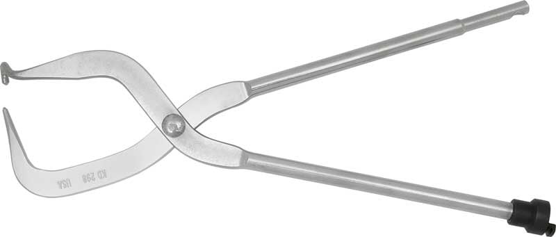

I hear a lot of people have problems using parts store drum hardware kits but I bought the Dorman kit and also bought this Lisle Corporation and was able to get the spring, pin, and washers on to hold the shoes in place.
I'm sure they work fine and we're probably better than the napa ones. The napa ones were 3/16" shorter and the springs were so compressed they were putting too much stress on the retainers. I had to take both sides apart because a retainer popped off from the stress and was making a hell of a noise when driving. I put oem on and all good.
There is a tool for the springs too. I have a toolbox that has a drawer dedicated to brakes.
it's also handy to have the pinch tools to push or hold the wheel cylinder Pistons in while your working on the rear brakes.
Edit. Called a piston clamp.
I bought one of those spring tools and I could never make it work. It just doesn't seem to fit in there. A pair of needle-nose Vise-Grips does the job quickly and easily. Never saw a need for anything to hold the cylinder in, either.
