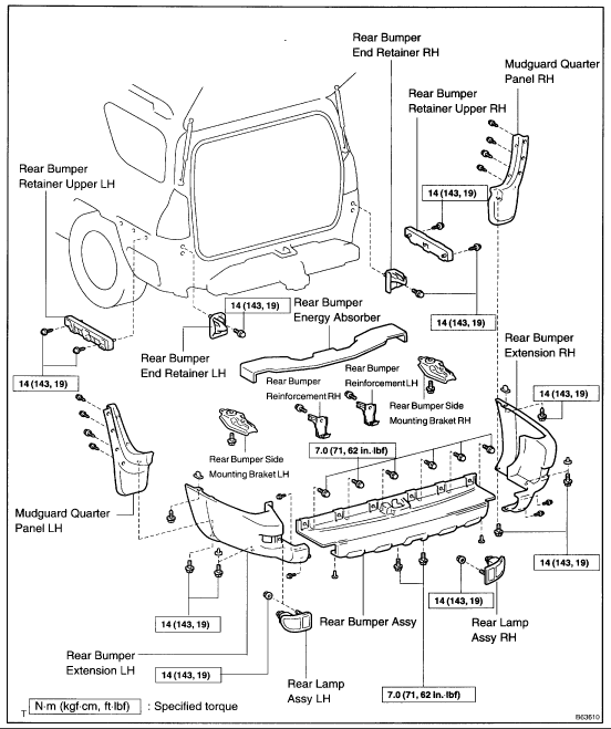

I am test fitting a new cb mount that is coming to the market for 4th gens finally. But I need to remove my rear bumper to put a backing plate on. Is there a good guide to how to remove my rear bumper? I cannot find a good thread with photos.
Thanks
its just a bunch of 10mm bolts and a couple plastic fasteners...you can prolly just remove taillight and one side of bolts and fasteners as needed to pull the bumper far enough away to install bracket
