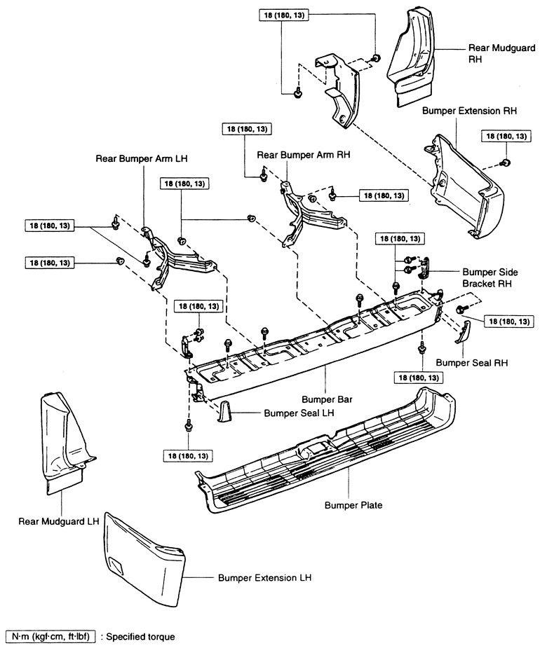

Does anyone know how to remove the upper plate of the rear bumper on a 2001. I want to take mine off and paint it.
Thanks
Look underneath and you will see the plastic clips holding it in place. Squeeze them to pop them out, then just pull the plate off....easy.
