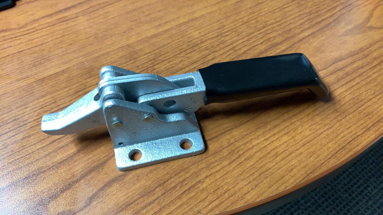

Thank you.
I know what latch you are referring to and it looks to be an amazing design. I have no first-hand experience with it though.
We’ve used a lot of different latching mechanisms on Jeep swingouts over the last 16 years. When it comes down to it, K.I.S.S principal applies. Some of those boring latches actually work better than overly complicated latch mechanisms. You also run into a supply issue. It’s not good for customers if the only option for replacement parts is through the manufacturer. We are not a latch company. We are an armor manufacturer, so it’s wise to stay in your lane and not cause difficulties producing something you have no specialty in.
We will be using a latch like this, rather than a draw-pull latch. They sit much tighter to the face of the bumper and work well.

Well, atleast its flatter than some ive seen. Maybe weld on a garnish or some sort of finishing touch to the mech?

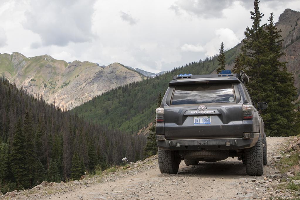

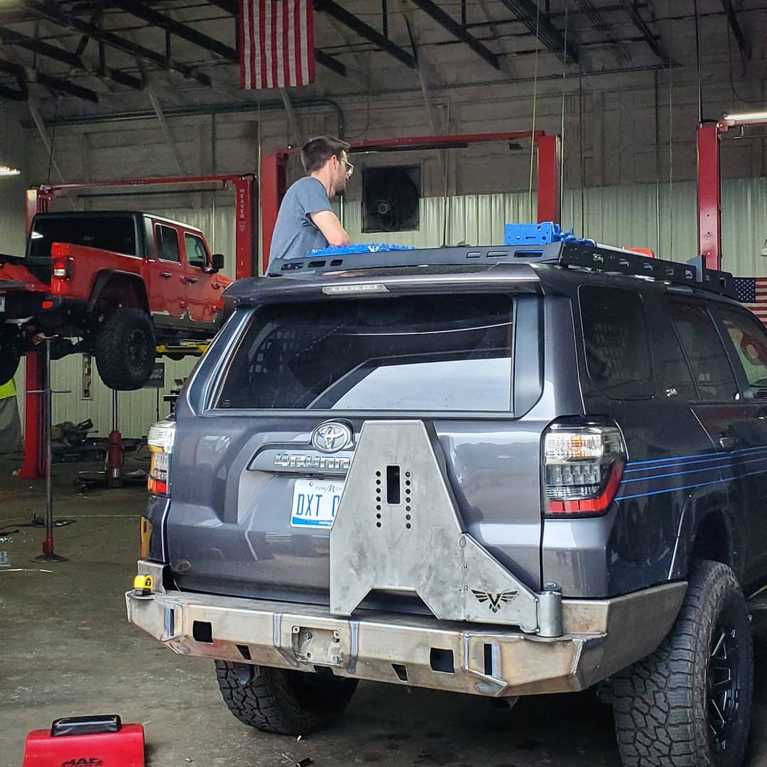

The prototype rear went out to Colorado! Lots of other projects have gotten in between but engineering is back on the rear bumper/swingouts this week. More info soon!

Looks like the recovery tabs are pass through and welded on both sides?
Not just a surface mount and weld?
The recovery tabs on my Victory 4x4 front bumper go through the bumper and are welded on both sides. Not just welded to the inside and outside faces, but also fully welded to the piece that bolts directly to the frame. Guessing the rear bumper is going to be the same.
Good to know.
It seems a lot of them are just surface welded from what I can see.
