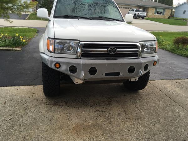

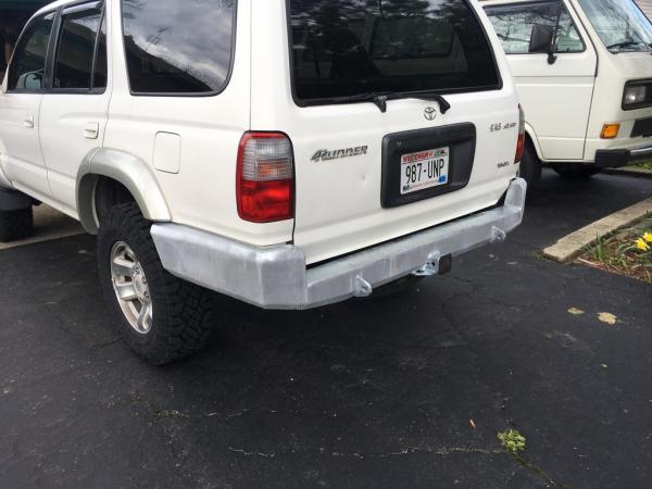

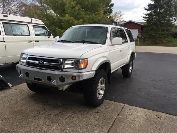

The fabrication is top-notch and their customer service is exceptional. Their rear bumper is truly DOT-3 rated.
I purchased both front and rear bumpers over a year ago (I took a 300mi road trip to save shipping costs) and had them hot-dip galvanised at a shop somewhat local to me in Milwaukee for $150. Everything went perfectly, although I did have to purchase a receiver with more drop to level my trailer.
96-02 4 Runner Rear Plate Bumper

Riceye;3655188 I purchased both front and rear bumpers over a year ago (I took a 300mi road trip to save shipping costs) and had them hot-dip galvanised at a shop somewhat local to me in Milwaukee for $150. [/QUOTE said:
