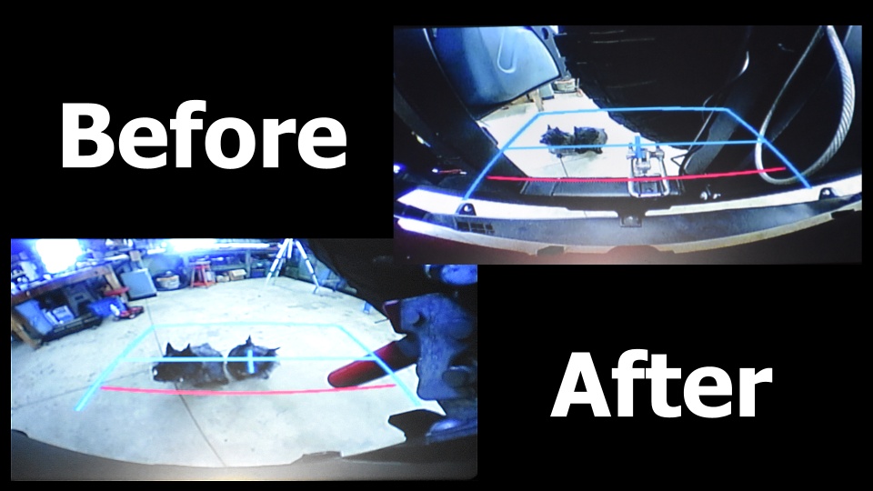

Since we moved our spare tire from underneath to the swing-out arm on our bumper, our camera was blocked and useless. Using a premade wire harness with factory style plugs we were able to relocate it to a better, unobstructed spot. At first it looked like a daunting task but once we jumped into it, everything went incredibly well! In all it only took a couple hours, a 10mm socket, screwdriver, and crimping tool to get the job done. Below is a detailed video on how to tear the hatch apart to get to the camera, mount it in its new position, and run the wires.
Makes a big difference!
