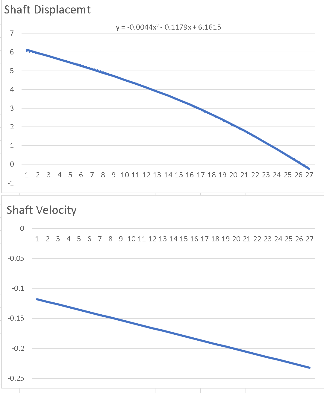

Cantilever geometry at ride height
<a data-flickr-embed="true" href="https://www.flickr.com/photos/147275993@N05/49230271303/in/dateposted-public/" title="Screenshot (2)"><img src="https://live.staticflickr.com/65535/49230271303_1ab5fee476.jpg" width="500" height="281" alt="Screenshot (2)"></a><script async src="//embedr.flickr.com/assets/client-code.js" charset="utf-8"></script>
I know you already know this... but watch those motion ratios. :madgrin:
-Charlie
Motion ratio right now is around 1.625:1 with a coilover shaft velocity curve that essentially linear to gradually increase the dampening as it approaches full bump this will compliment the hydro bumps quite well. In reality the attached graphs will be inverted so slope is positive they just worked out negative because of how i took the measurments since I started from full droop cycling to full bump
