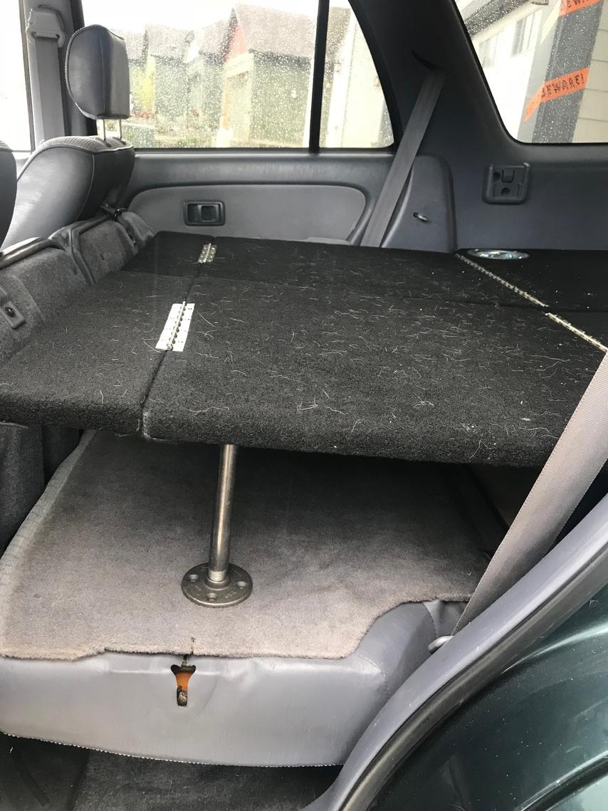

That's the thing.. figuring out how to make it sit flush as a sleeping platform. It would be a really cool idea though if I can figure a way to make it happen.
Would it really need to be flush? If you sleep with your upper body that end add something too make it flush, if feet end who cares. Maybe cut a piece of plywood or UHMW to use as a camp surface, cut a hand hole, set it on the ground, rocks, on top of drawers you have pulled out ? Most folks make the top with 3/4-1/2" material not alot to worry about IMO, But you have to consider where am I going to store it when not in use.

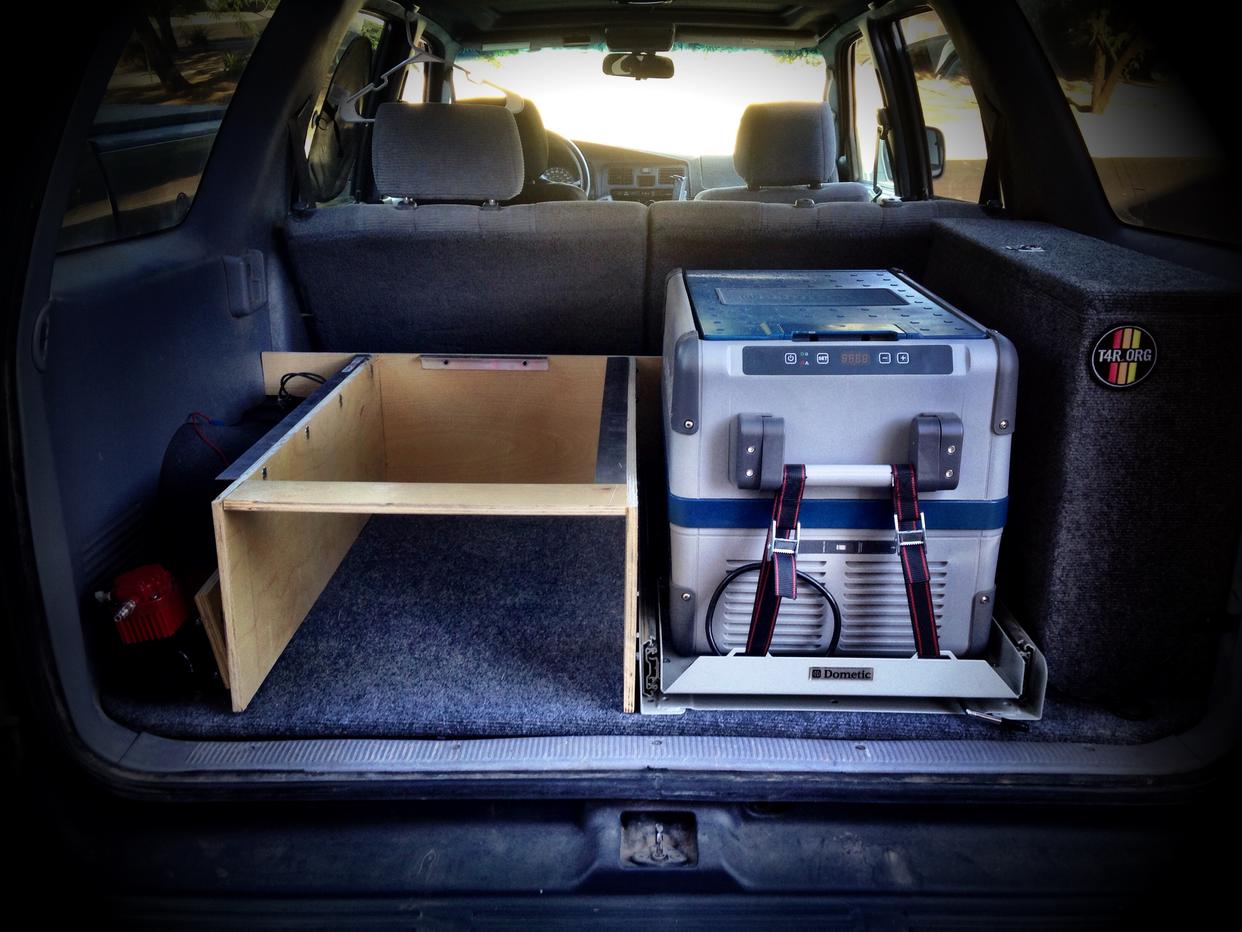

Here's mine. Not really cargo, more refrigerator. We use the Front Runner bindu boxes for cargo and they fit snug on the left side of the fridge.

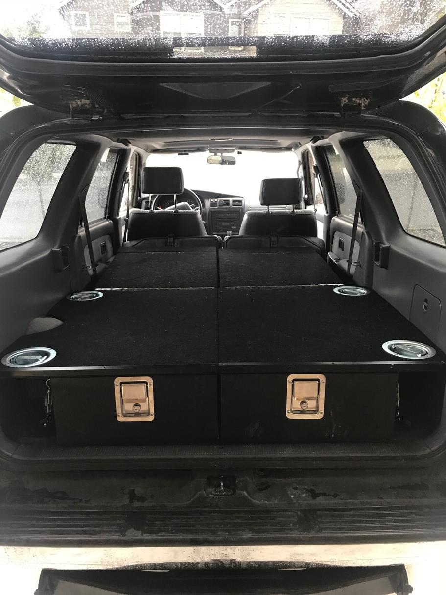

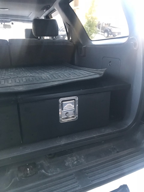

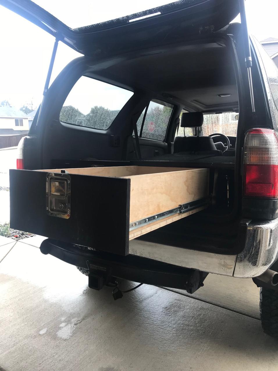

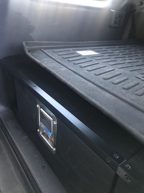

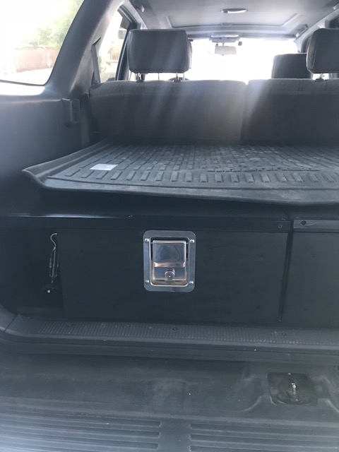

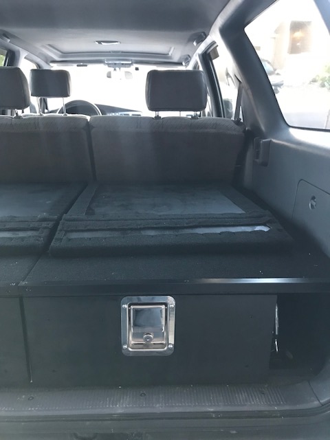

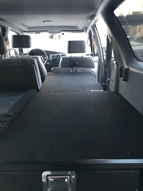

Finally finished mine, took a few weeks but took my time on my Sundays and Thursdays off.

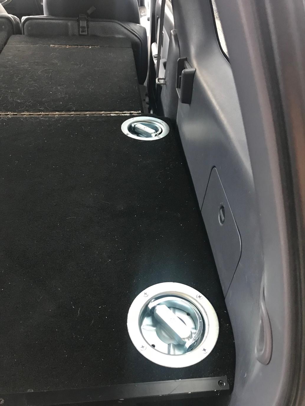

Added some 360* swivel d ring tie downs. Amazon FTW.

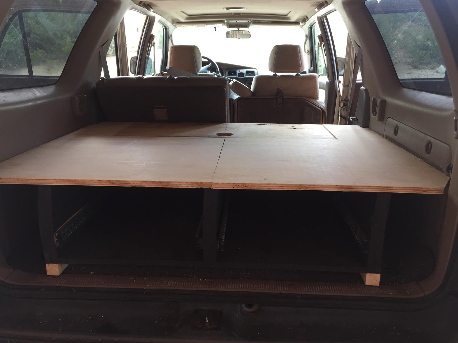

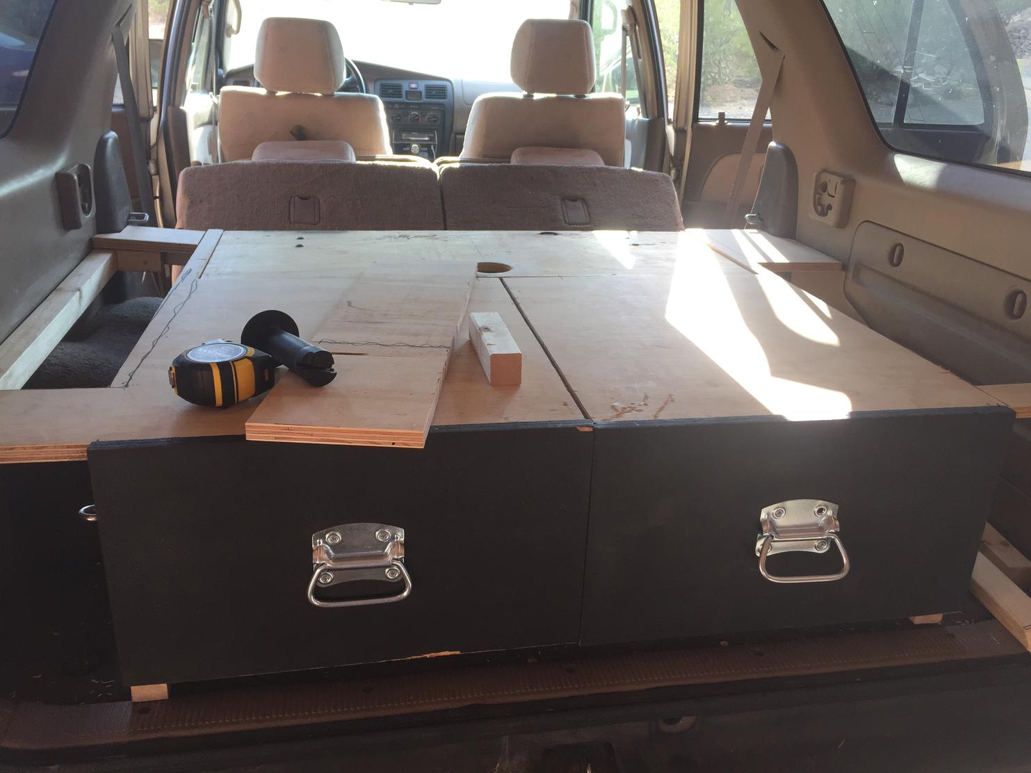

02 Storage Sleeper
Work in progress on my '02 ... everything is glued and screwed with the exception of the top so that I can get back in and install the drawers/sliders.
that is exactly the height and style i want to build. having the wings resting on the wheel wells. looking forward to the finished product. and when you do maybe i can see the plans?
