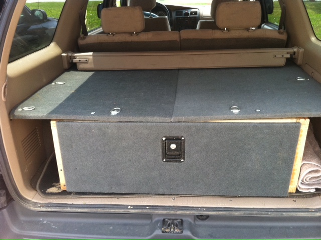

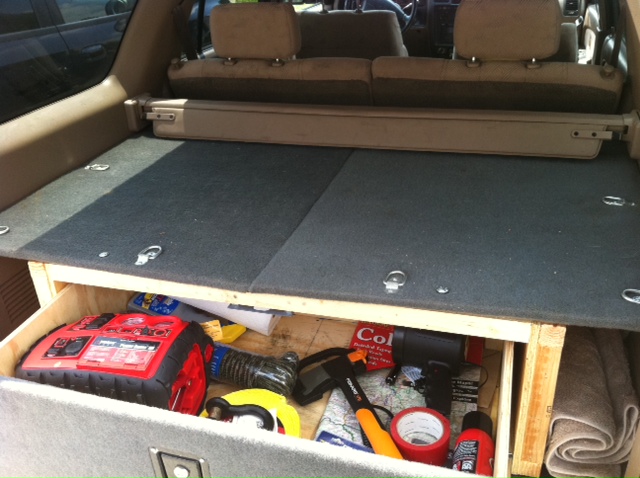

Well holy crap, this super nice guy had bought forum member "jsmarine" 4rnr and wanted to get rid of the storage box.
What a deal! Looking forward to fine tuning it for my upcoming trip to CO - it will be perfect!! Free is perfect for my budget.
p.s. that 4rnr is totally badass, neat to see one built as that one up close, never seen anything like it in person.
