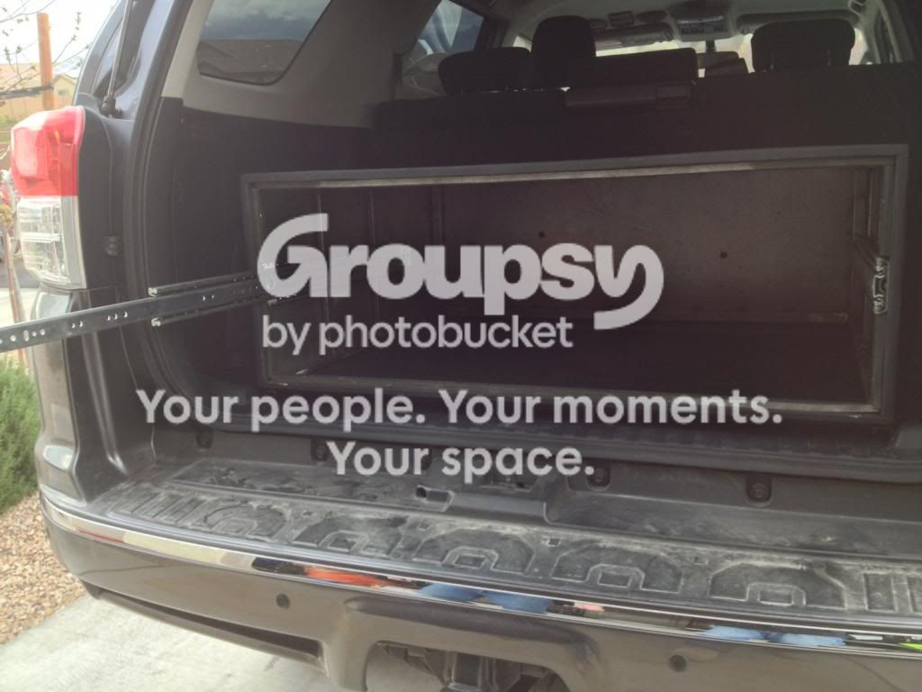

Mine is filling the entire rear area starting from the back of the rear seats and going to the rear hatch, and will be 14" high of usable interior drawer space (I can't remember the exact specs). I wanted enough height to be usable space and still allow my German Shepherd to sit on it and not feel smashed between the head liner. I will have mine mounted to the truck by drilling 4 mounting points down through the floor with the bolt heads under the drawer incase anyone got the nuts off they wouldn't be able to pop the bolts out of the holes without removing the entire drawer.

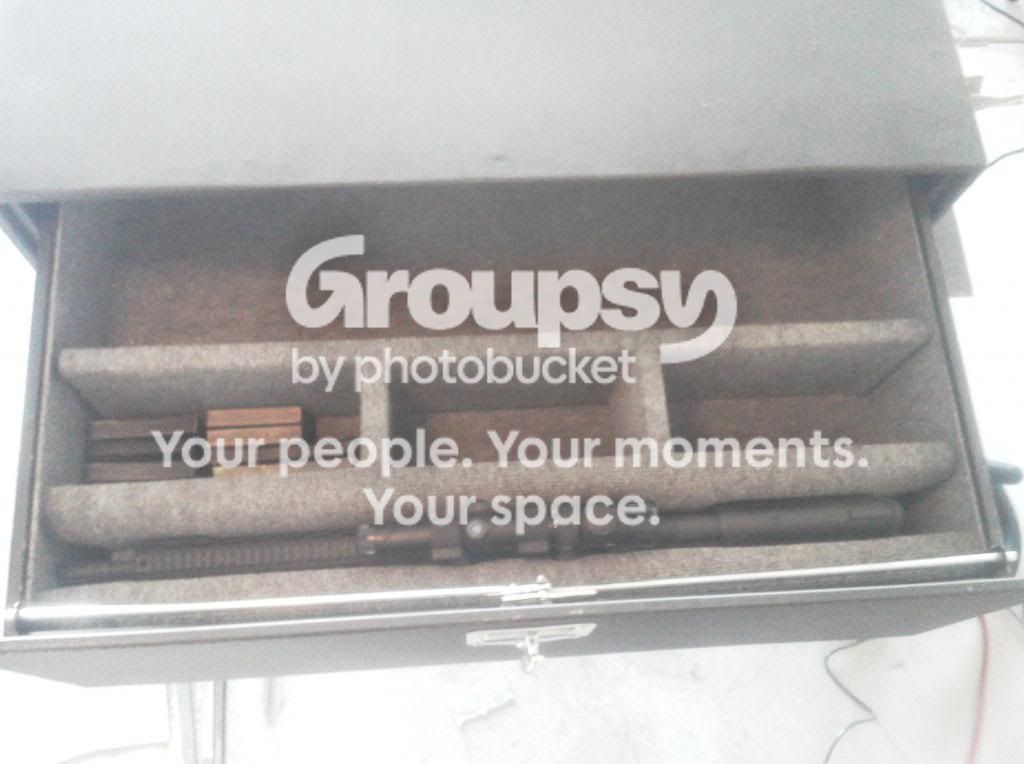

The skeleton of the box is constructed from 16 guage square tubing of various sizes depending on the funtion of it in the construction. The skin of the box and the drawer is 16 guage cold roll steel. There is a three point flush mount T-handle locking mechanism and the drawer slides I will be using are Accuride or Kape and Vogt extra heavy duty slides. It will have a seal around where the drawer and box mate to keep dust and what not out (you guys that have also been in the sand box know how sand gets into any small crevice) mine will have towards the front of the drawer three equal length area's for .308 and 5.56mm magazines and the next row will be the width of the drawer and maybe 5 inch deep to accommodate an AR15 or SCAR17 sized rifle.

So another Officer has a side business building steel security doors or pretty much anything you want, he made the front bumper on his Silverado and has made other vehicle accessories for other Cops. So I asked him if he would like to tackle this project and he accepted. When I showed him the specs on ARB and Tuffy he just shook his head and said "I can't believe they charge this much for that product, I will make yours stronger, to your specs and whatever options you want for half or less", So I said "copy, lets do it"
He will make you any size you want in any configuration. Mine is filling the entire rear area starting from the back of the rear seats and going to the rear hatch, and will be 14" high of usable interior drawer space (I can't remember the exact specs). I wanted enough height to be usable space and still allow my German Shepherd to sit on it and not feel smashed between the head liner. I will have mine mounted to the truck by drilling 4 mounting points down through the floor with the bolt heads under the drawer incase anyone got the nuts off they wouldn't be able to pop the bolts out of the holes without removing the entire drawer.
I will find out the gauge steel but I know it's thicker then the ARB and Tuffy, the drawer rollers are rated for 1000 lbs (I told him I wanted the truck to break first), it will be lockable and the lock will tie into 3 side of the box to make it strong, it will have a seal around the drawer to keep dust and what not out (you guys that have also been in the sand box know how sand gets into any small crevice) mine will have towards the front of the drawer three equal length area's for .308 and 5.56mm magazines and the next row will be the width of the drawer and maybe 5 inch deep to accommodate a M1A SOCOM 16 or M4.
Mine is still in production as this is a side gig and he's been working on it for maybe 1.5 months but he's stated that when he produces these the timeline will be shorter since he can use some specs from mine and he will also have already built mine and will know what to do and how to source things like rollers, lock etc...
Cost will vary on how large you want yours and how stout you want it made, mine set me back $800 and I think that is a hell of a price.

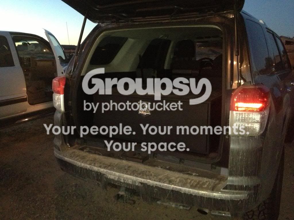

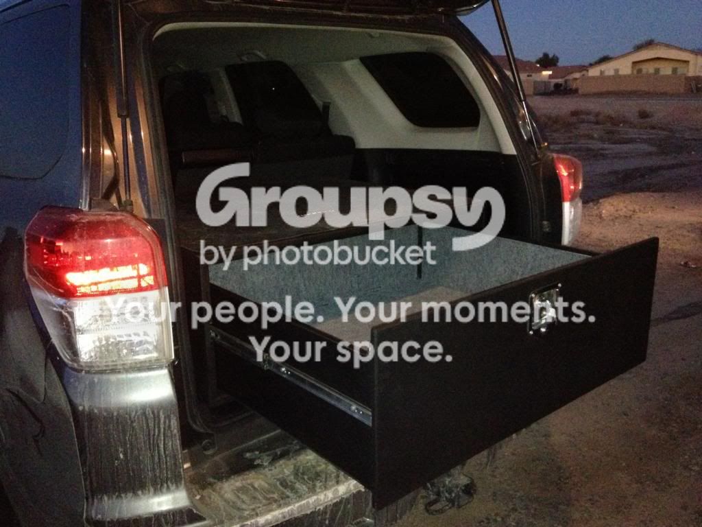

Box is done, well has been done for awhile. I let him use it to demo to some other local agencies. I have abandoned the idea of having my german shepherd sitting on top of this, I just bought him a hammock like this Amazon.com: Kurgo Wander Hammock Seat Cover, Black with Orange: Pet Supplies
this gives him and the bulldog the back seat. Since that plan isn't going to happen I may mount another box on top of this maybe half the size, not sure yet...
I've had a couple people show interest in this, I know it took awhile but as I stated he was doing this on the side off duty but he is now set up to make them in a realistic timeframe. If interested let me know
Also if you look in the second photo you will see the OEM Toyota rear cargo carpet mat sitting on top of it. Give you a idea of how much room it takes up, if you need dimensions or have any other questions let me know.

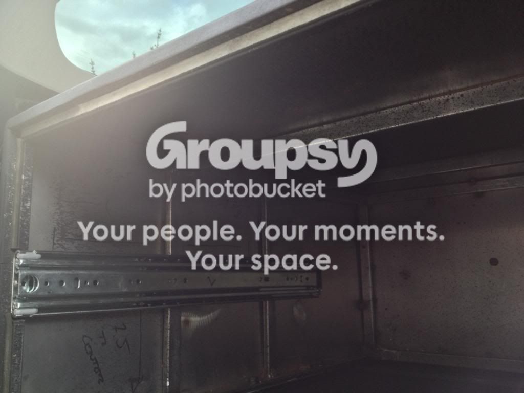

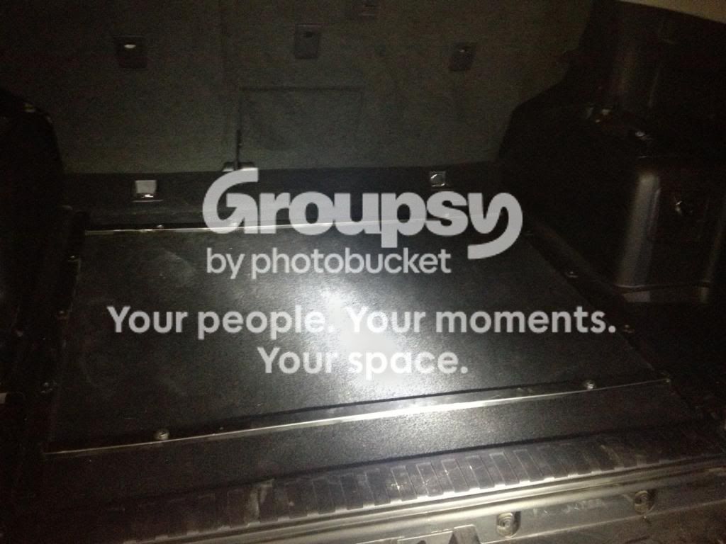

Kind of going backwards but here are a few shots of the interior structure, and the mounting plate we made so that if you wanted to removed the entire box you remove 6 bolts that attach the box to the mounting plate and the plate is bolted through the sheet metal of the truck and has 6 nuts welded to it. This way you can take the box out if needed and the mounting plate stays behind instead of crawling under the truck but you still need to gain access to remove the drawer to get at the 6 bolts so it can't be stolen even if you removed the four nuts under the truck holding the plate down. Sorry for the crappy last photo it was dark by the time we finished up.
