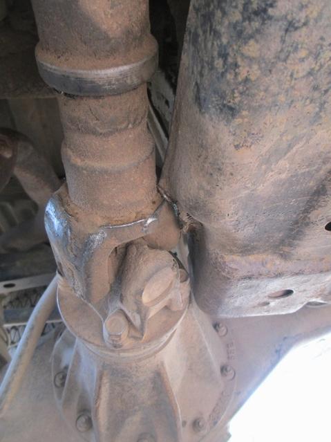

With 7 wraps. Lc shocks and lowered stops I can flex out so far the driveshaft slams the gas tank. If you create a lot more travel it will get worse. I removed rear sway bar to test the extra travel and damn near sheared the bolts on the rear driveshaft.

Once you get this thing wheeling you will realize the limits of our suspension and gas tank location.

I dont know anyone with a good flexing setup that clears the gas tank. During heavy flexing situations you will always hit as long as you have some good travel. GOOD LUCK!

Yeah, never said your wrong. Just giving you my experiences. I know peeps usually relocate the tank once it becomes an issue. Lowered bump stops in my situation saves my LC shocks from overcompression. Helps keep my 305s from rubbing wheel well (they love to hit the gas filler neck cover which I had to trim a bit) and gives a nice soft transition. Any more uptravel would not work with my tires. My soft bump stops also are a lot better than those solid as a rock rubber ones. Before the stops you could feel it slam into the stop, now its smooth sailing.
I have hammered my tank shield as far as I could to help clear. Also make sure to replace the rear zirk fitting on drive shaft with a small screw because it will sheer off when it hits the tank and you wont beable to grease the shaft without drilling it out.

this is true, with our link setup, the driveshaft will eventually make contact with the gas tank. another issue ive found is the bump stops limit bump travel too much if you set them up for flex travel. I think if you moved them towards the drum they would work properly.

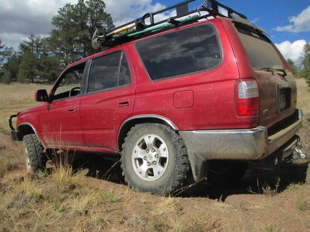

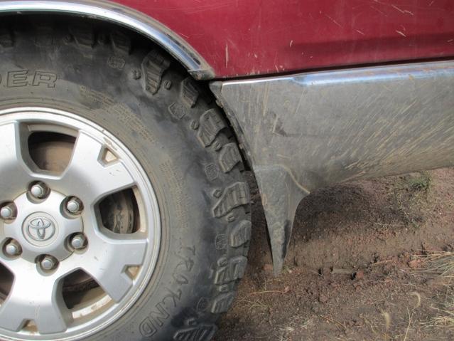

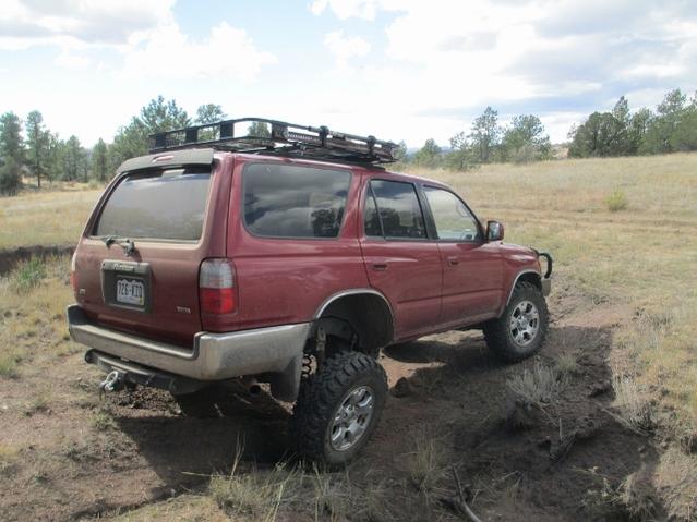

I'm not going to try to talk you out of doing something different, new or cool ( and 7100's are that. ) but I can say that my Trundra 5100's are not the limiting factor on my suspension . Tire size limits up travel and the drive line-gas tank skid limits down travel . Although I saw in your build tread you already clearanced ( is that a word ? ) your wheel wells so maybe you can gain some travel. Let us know ! And since everybody loves pics . driveline & gas tank skid (1) (640x480).jpg

Thanks for the input! Did you have to add extended bump stops? I already "clearanced" my wheel wells. Wasn't hard at all. With a new bumper I will have probably another "1 of clearance in all directions in the rear. Maybe not quite 1" at the gas filler tube but I don't rub anything at the moment. That's why I don't want to lose my up travel so I can get some serious stuffage. If I ever run 35's I may need to extend the stops but I'm going to try not to have to do that. Eventually I'd like to relocate my gas tank in the spare tire location but that won't be very soon. If I end up hitting the tank I'll just shorten my limit straps till I don't hit anymore. With the 12" shocks I should have plenty of shock length to spare for later on down the line. That's another reason I'm doing this, so I don't need to buy shocks twice for the rear
I have't yet but I probable should . Just broke & lazy . I've had the 5100's about 2 years and have't blown them out yet but I've read my 891 springs will start to sag when over compressed . BTW The pics were taken with the sway bar links ( extended ) attached .
