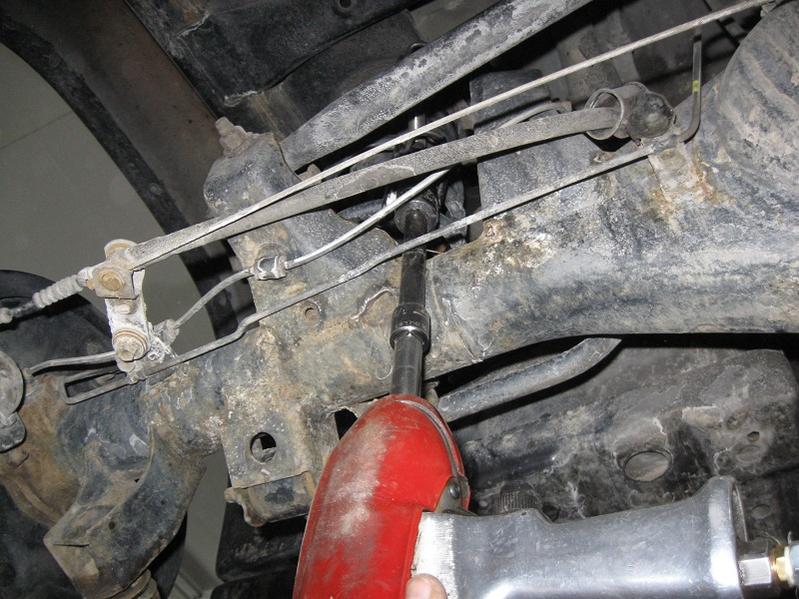

I also disconnected all of the brake line mounts along the axle so as not to put any extra stress on the lines. It is just a about six 12mm bolts. Then like the others stated, dropped the panhard bar, disconnected the shocks (17mm bolt) and disconnected the sway bar from the axle. With the wheels off and the frame supported you can drop the axle far enough to push one side down and remove and insert the coils.
I tried putting LC coils in one side at a time but couldn't get enough space to get them in. After asking for help ended up doing what is mentioned above with jack stands on both sides of frame, both wheels off, panhard bar off, sway bar disconnected and brake line mount disconnected. Then axle would drop enough by lowering the jack down to get them in by slightly pivoting the axle on the jack

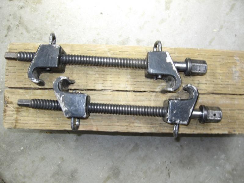

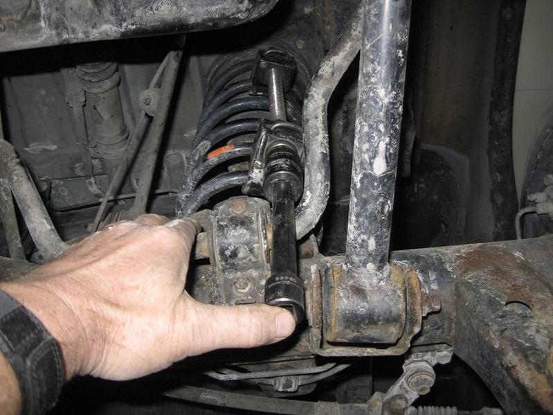

Updating this to help if someone find it in a search. Just get some spring compressors, jack up the frame until tires just leave ground (full drop), remove current spring, put in new spring. Super fast to do...less than an hour...two if you have never done it.
That seems a lot quicker than removing everything but need to be careful when using the spring comoressors
Just make sure the set of spring compressors you get is in good shape and has locking pins. It doesn't take that much compression to get the springs out. I just did this swapping from 7.5 wraps to OME861s and it was much easier than when I swapped from stock to 7.5 wraps.
