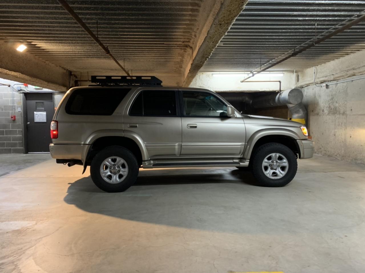

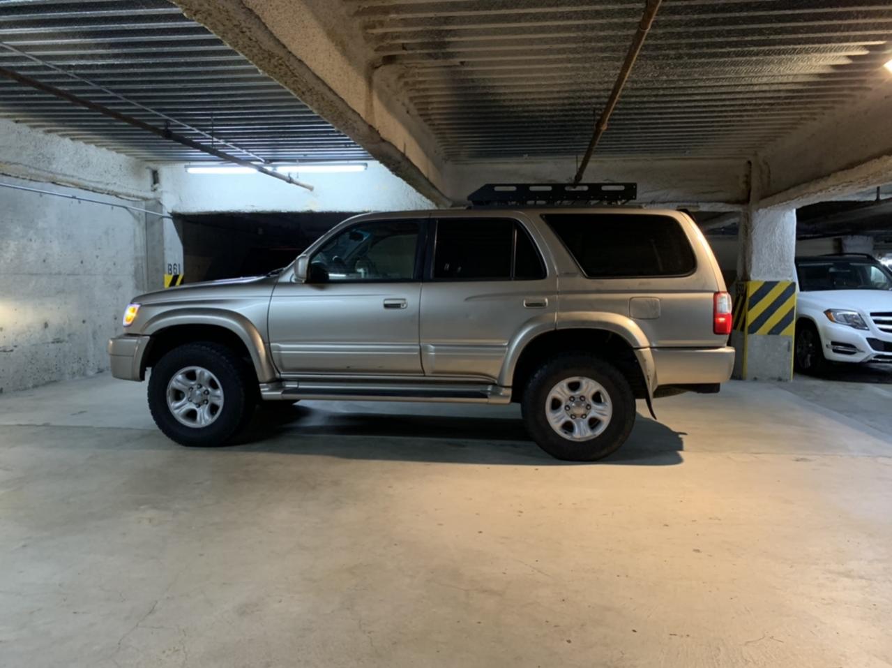

My 3rd gen lift
After months of reading and searching I finally got my lift yesterday. Sharing some pics here in case it’s helpful.
I have a 02 Limited. I went with Bilstein 5100, OME 906 in rear, and I found 99’ front coils set to the 2nd perch on the front shocks. Car went up about 2”. Really happy with the results.
