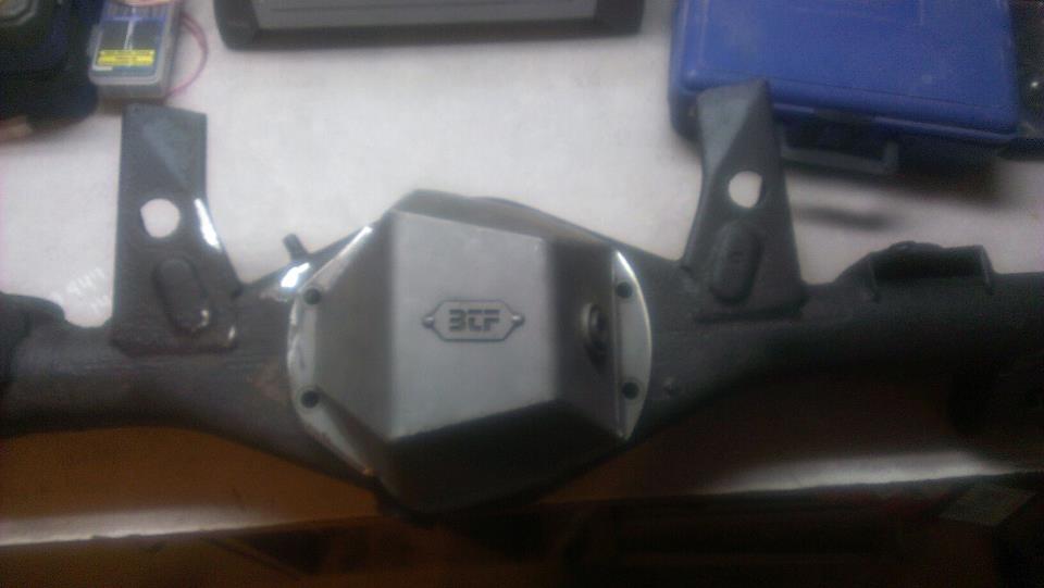

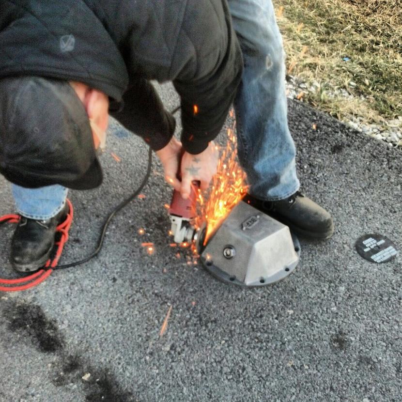

What i used - blue torch fabrications kryptonight rear FJ 40 diff cover you could use a stock fj 40 rear cover if you didn't want a 1/4 inch steel cover this cover had to be modified a little as you can see in picture, i cut the top and bottom flange completely off
BTF Toyota FJ40/LandCruiser Rear Kryptonite Differential Cover :: Blue Torch Fab

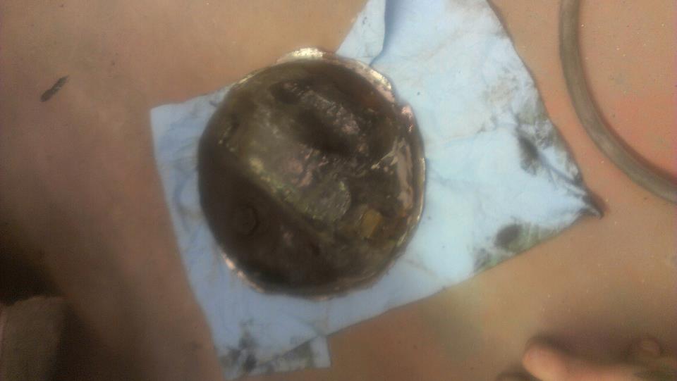

first step was drain fluid, then take the pan har bar off, I did all this with my rear still under vehicle. then i took a grinder and grinded the factory weld around the cover flat. then took a air chisel and just cut around the weld which worked great it came right off. i then took rags and plastic and wrapped around the gears so no metal made its way inside while i was smoothing out the area around the diff i was going to weld to. to make sure i had no metal i sprayed a full can of brake cleaner on the gears and flushed it out good. then finally simply weld new cover on

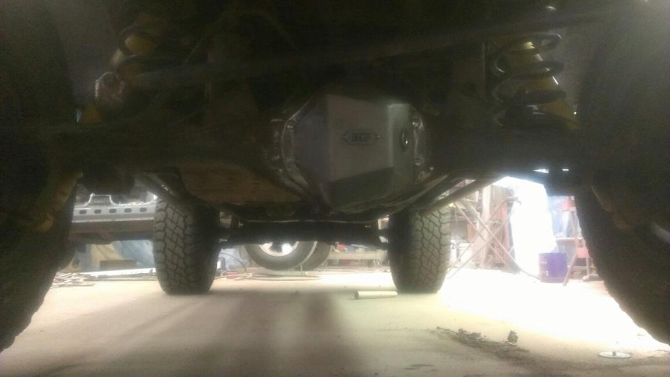

Refill was 3 full bottles of gear oil, i believe that's more than factory maybe not. I was worried about it at first but when i tore into this project i came to see it was very easy if you know how to weld and have a decent welder to use. I didnt time how long it took but i would guess around 1.5 hrs start to finish. I will never have to worry about smashing rocks or it rusting through any more.
So not only is it a functional part of the diff now, it's also 100X more stout than oem... nice work! I would have been a little anxious about leaving the 3rd in. I myself probably would have removed it.
Yeah i have a spare housing but im elocked and i figured if i had to pull axles and gears and modify the stock housing with good cover for my elocker I should just fix my stock elocked housing, i would have rather took the rear out but thats alot of work and if you are careful leaving gears in is not to big of an issue... Yea this cover is 16 pounds! its overbuilt and the new fill plug is recessed. all around it turned out great.
