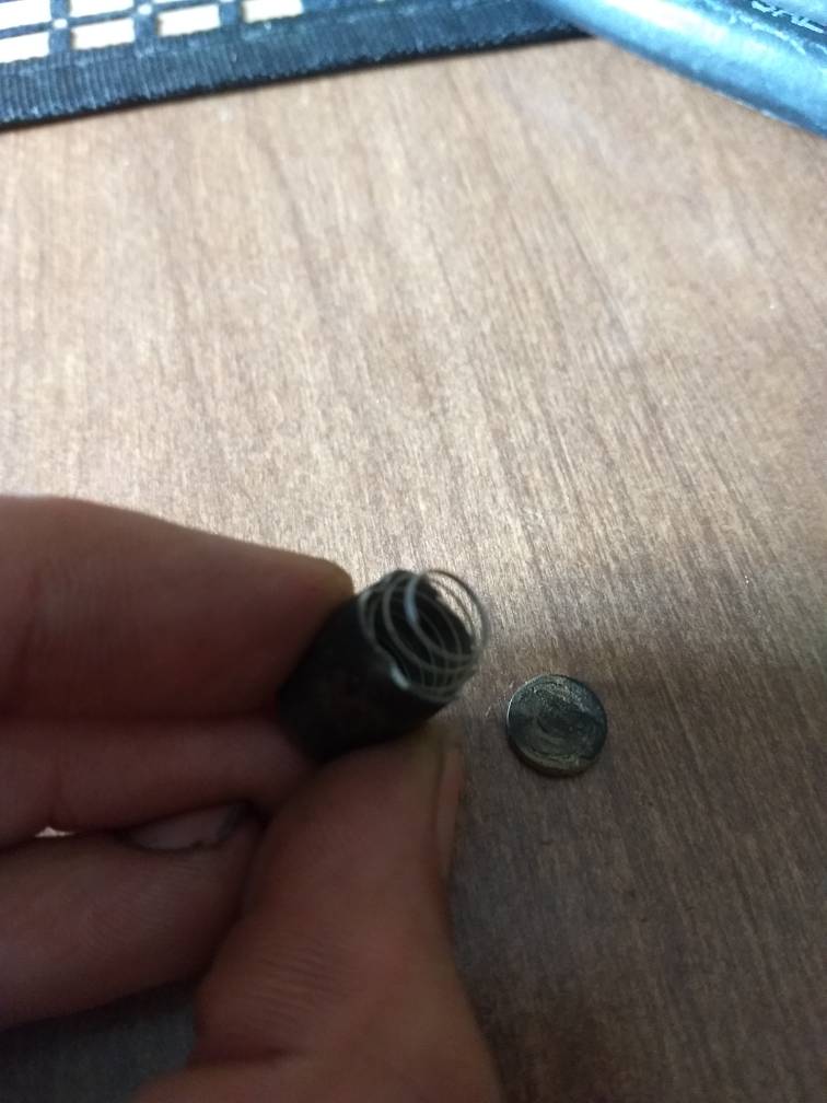

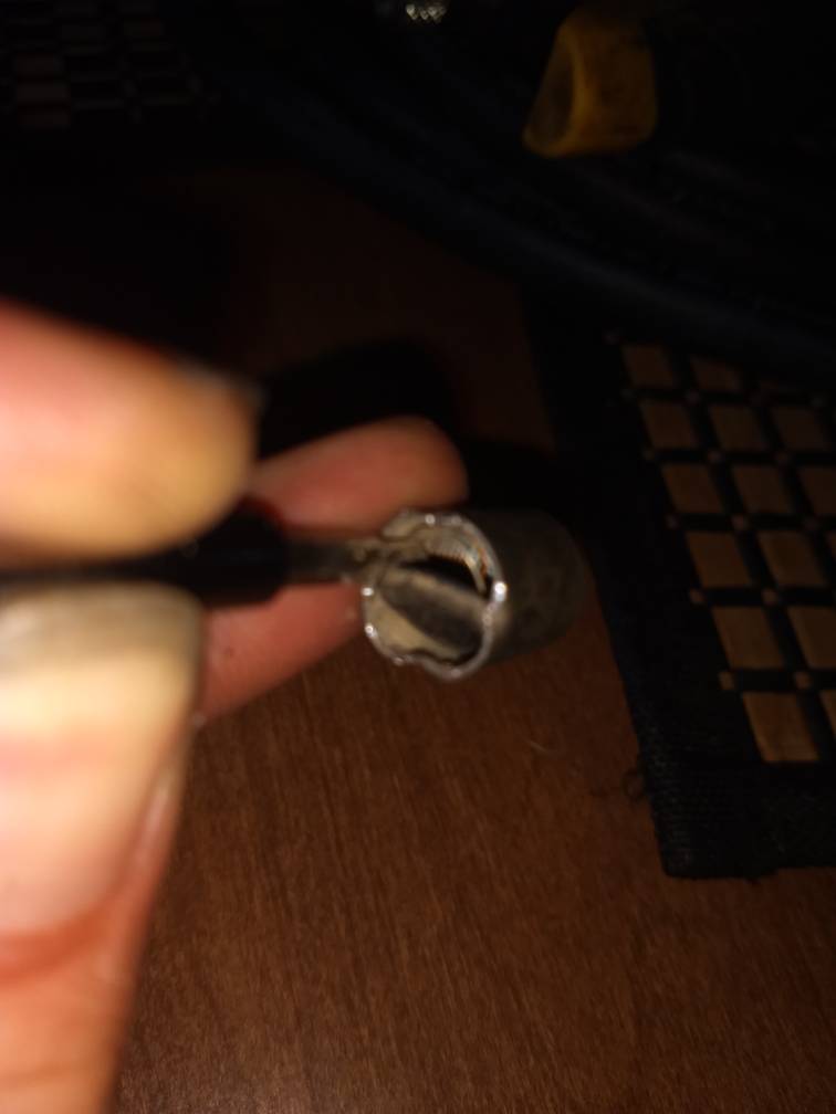

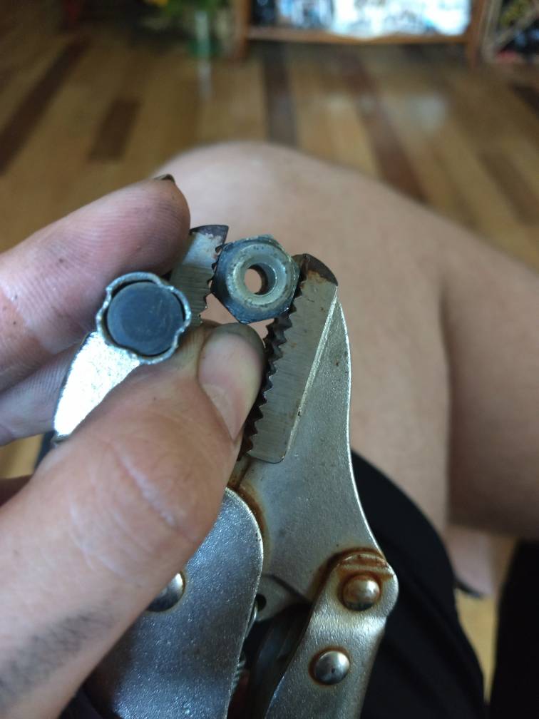

Checkmate hookers. It's a one way valve. Relocating the stock diff breather WILL NOT protect you from submerging the diff in water.
I guess I'm not debadging my bumper after all.
The ARB diff breather page explains it best.
The factory breather IS a ONE WAY VALVE.
Check out the proof.
