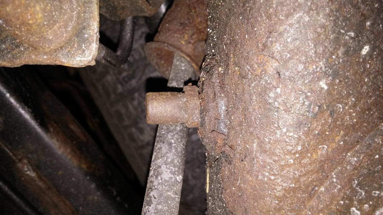

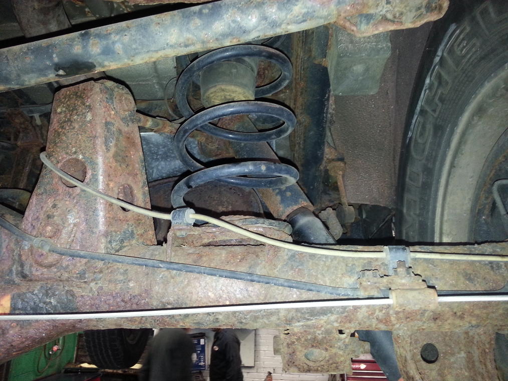

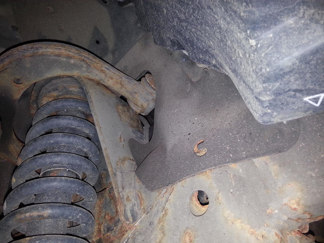

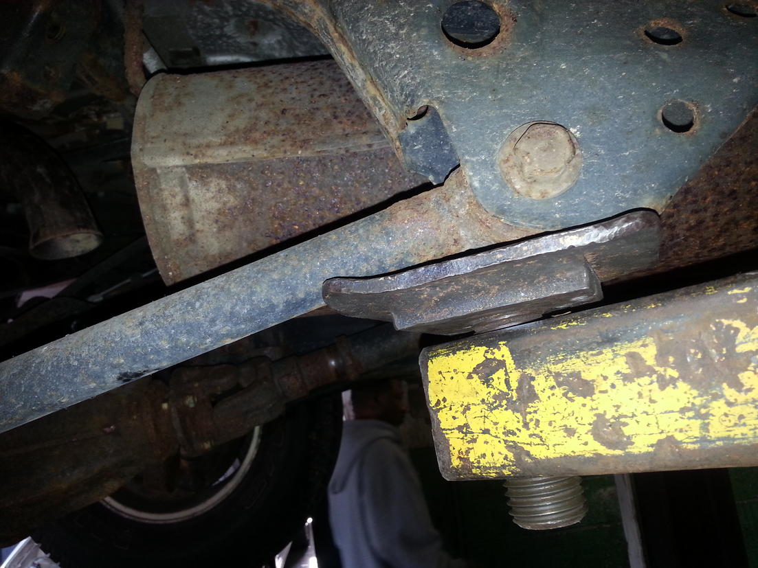

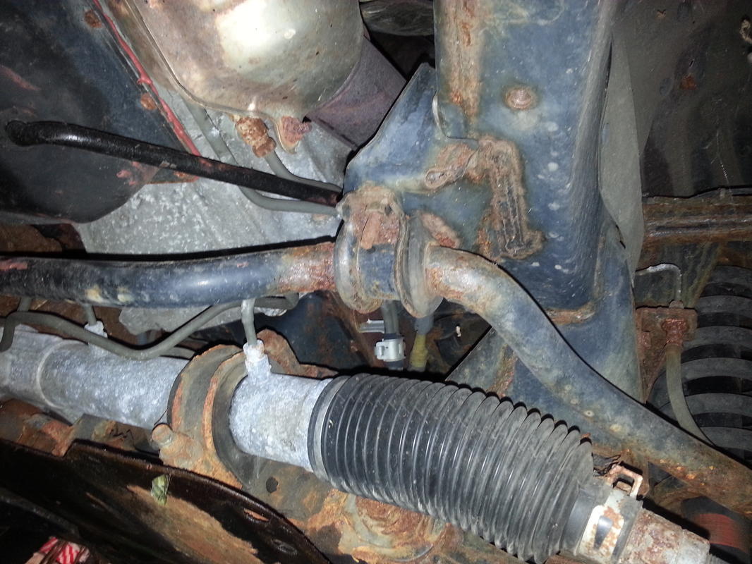

Picture of around the muffler. The frame is mostly like that, patches of rust of varying degrees. no holes. Its fluid film checked back a few days ago, after a 60 days, it its still greasy, pretty sure it should hold.
I dont know why every car isn't dipped in this stuff.
edit: its really the rear end that got the worst of the rust. It did sit for a few months with lots of salt on it and moisture.
