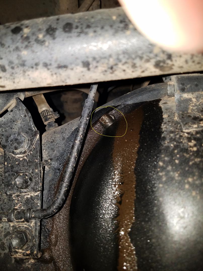

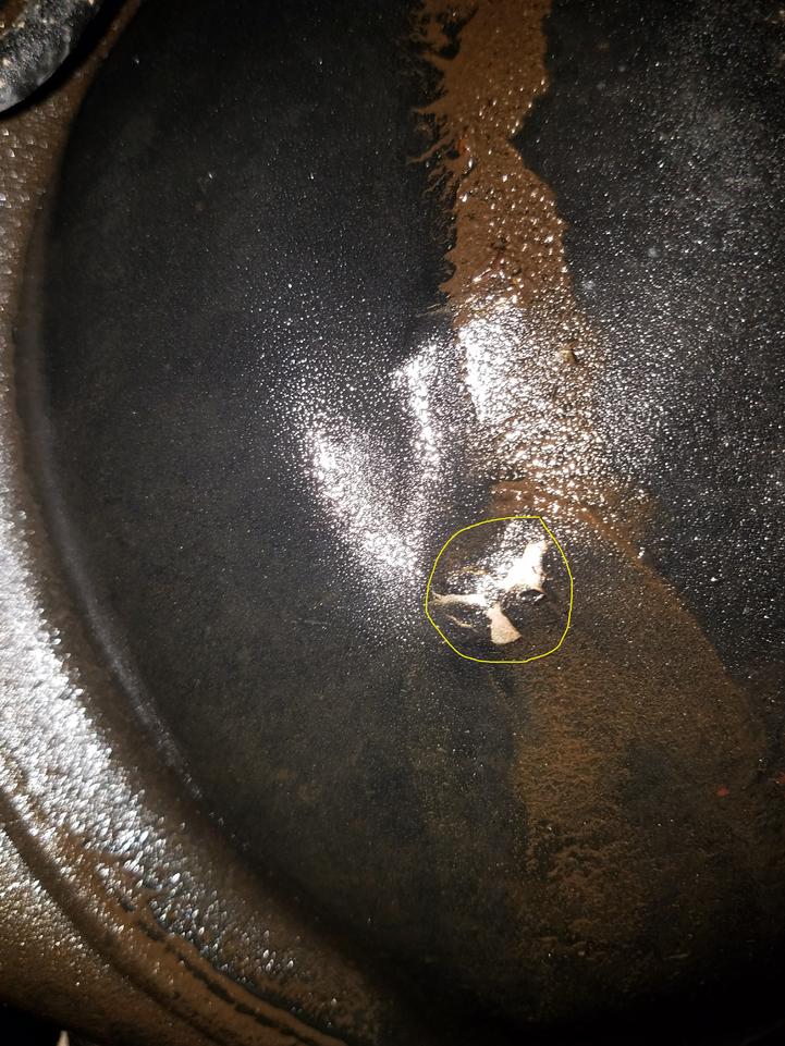

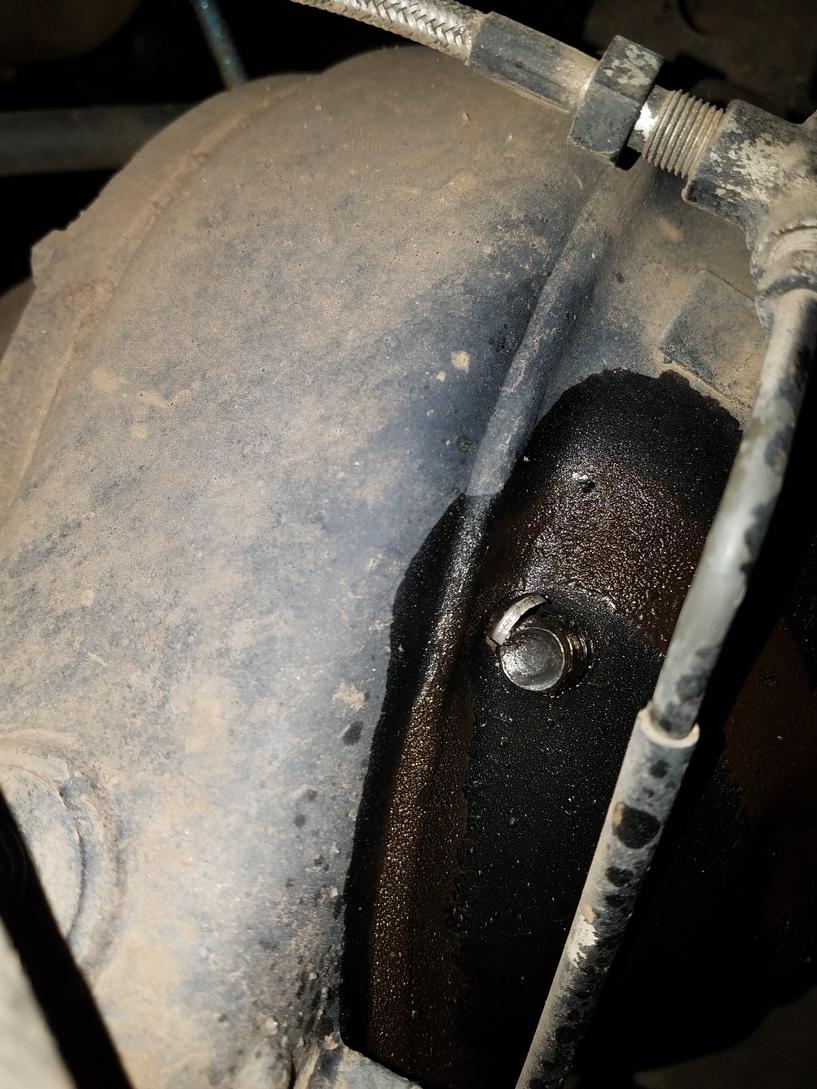

Anyone have any ideas where the bolt belongs? And what may have caused this?

I expect to see some damage. that looks like a ring gear bolt.
not properly torqued, or without locks or Loctite. or a combination of the 3.
Is there where the air line goes into the diff? Seems like it should be on the 3rd member itself and not on the axle housing. I don't have ARBs, not very familiar with how they're set up.
Edit -- now that I study it more I see that a bolt has been shoved from the inside out of the axle housing. Ouch!! Ring bolt would make a lot of sense in this case... guess the Loctite was forgotten
Have you drained the fluid to see if you have any chunks in there?

Ring gear bolt
Yes, I drained it last night. Found a small amount of metal 'dust' and 1 small (like an eye lash) pc of metal.
If that is a ring gear bolt protruding through the housing, and if ECGS did the gear install on the 3rd, then they owe you some serious make good
And if that is a ring gear bolt, you are super lucky it went outboard and got stuck vs ricocheted inwards, possibly lodging in the gear set or locker mechanism causing your entire rear diff to grenade on the fwy at speed causing lord knows what kind of incident

See if they can show you pictures of the ring gear being installed with Loctite. That's how Zuk does it. Pic from my rear diff being set up, courtesy of Zuk:

I just got off the phone with Seth at ECGS, they are gonna take care of me. You guys were indeed right (@nevada [MENTION=135317]rkntoy[/MENTION]), it is a ring gear bolt.
They want me to send the entire axle assembly to them so that they can weld a new Barney's HD diff cover Toyota Pick Up Heavy Duty Differential Cover and repair all damage inside. They are paying the freight both ways. I couldn't ask anymore from them. What a great company!
