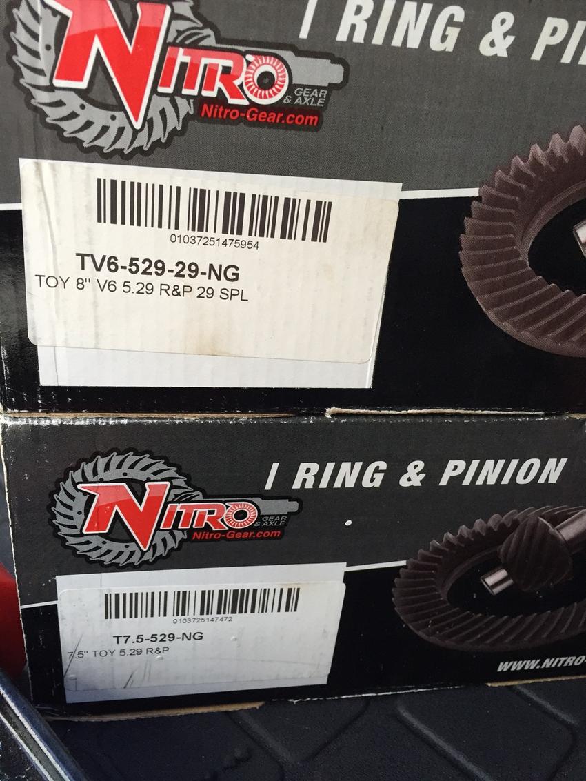

I purchased Nitro 5.29 gears and Yukon Master install kits and ARB Airlockers.

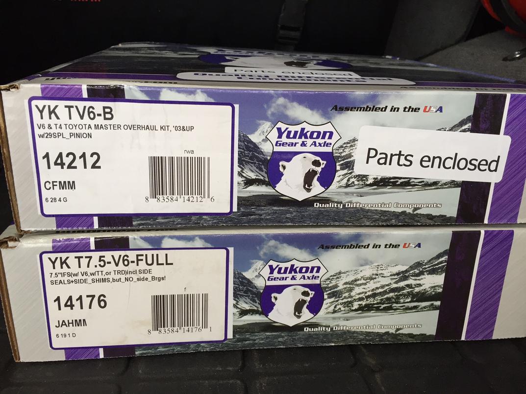

The Pic below will be the gears, the next post will be the install kits.

1 Note: I did notice the Yukon Install kit says the following (V6 & T4 Toyota Master Overhaul Kit, 03&UP w/29SPL_Pinion) Kit#14212.
The 03' & Up thing has me worried, is this the correct Master Install Kit?
