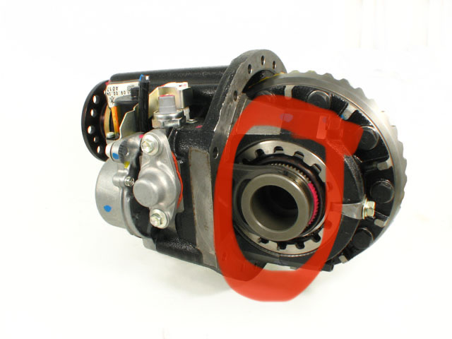

Team, reporting back here. The culprit was the thread on one of the third member towers. The load bearing side that also has the locker. The thread was beginning to collapse, which lead the backlash to increase over time since it’s one of the places where it’s controlled on the ring side. Picture here for reference. The installer said they’ve seen this on a number new of the 8.2” diffs with locker - says it’s the weak point.
Labor was covered under warranty. Parts weren’t - Nitro does not honor its warranty. Nitro basically said they don’t cover the gear noise and blamed it on the driver. The installer said this kind of customer service is very common for Nitro (beware). So I went with Yukon for new gears. The installer also put some tig welds with my consent to make sure that side does not come off the thread.

I'm a bit confused on what it means that the thread was collapsing. The threaded adjustment nut (the big ring you use a spanner wrench to tighten) was collapsing internally or the threads cut into the cast steel housing were failing? I've built a few of these diffs. I haven't seen it myself, but it seems a bit unusual. The bearing caps should hold the outer carrier bearing race in place once the preload is set even without the threaded adjuster nut. Ideally the bearing caps slightly compress the adjuster nut and mostly clamp down on the bearing race to hold it all tight.
But the bearings do wear. And if they were not fully seated when installed or they had more than normal wear I could see a loose ring carrier. Often 100K+ mile Toyota diffs will have close to zero preload. The best advice I know of from a very experienced pro builder is to basically tighten the toyota carrier bearings as tight as possible including any used ones you pull out. Just crank them down really tight to maybe 100 ft lbs or more on the adjuster spanner wrench. More than you can do with one of those scissor looking spanners.

Thanks, I’ve rebuilt these diffs too, albeit without the locker, and I was equally puzzled. The shop said there’s too much load on that side so when they removed the threaded ring there was very little thread left on the carrier. My guess is the clip wore out and developed play? Let’s see if the welds help keep it in place. The shop owner said they’re considering calling every 4runner they did the gears for to also put a few welds to prevent this issue as they’ve seen it before too. And the shop said the same thing about Nitro and Yukon - made in the same factory but Yukon has good customer service while Nitro never honored their warranty.
