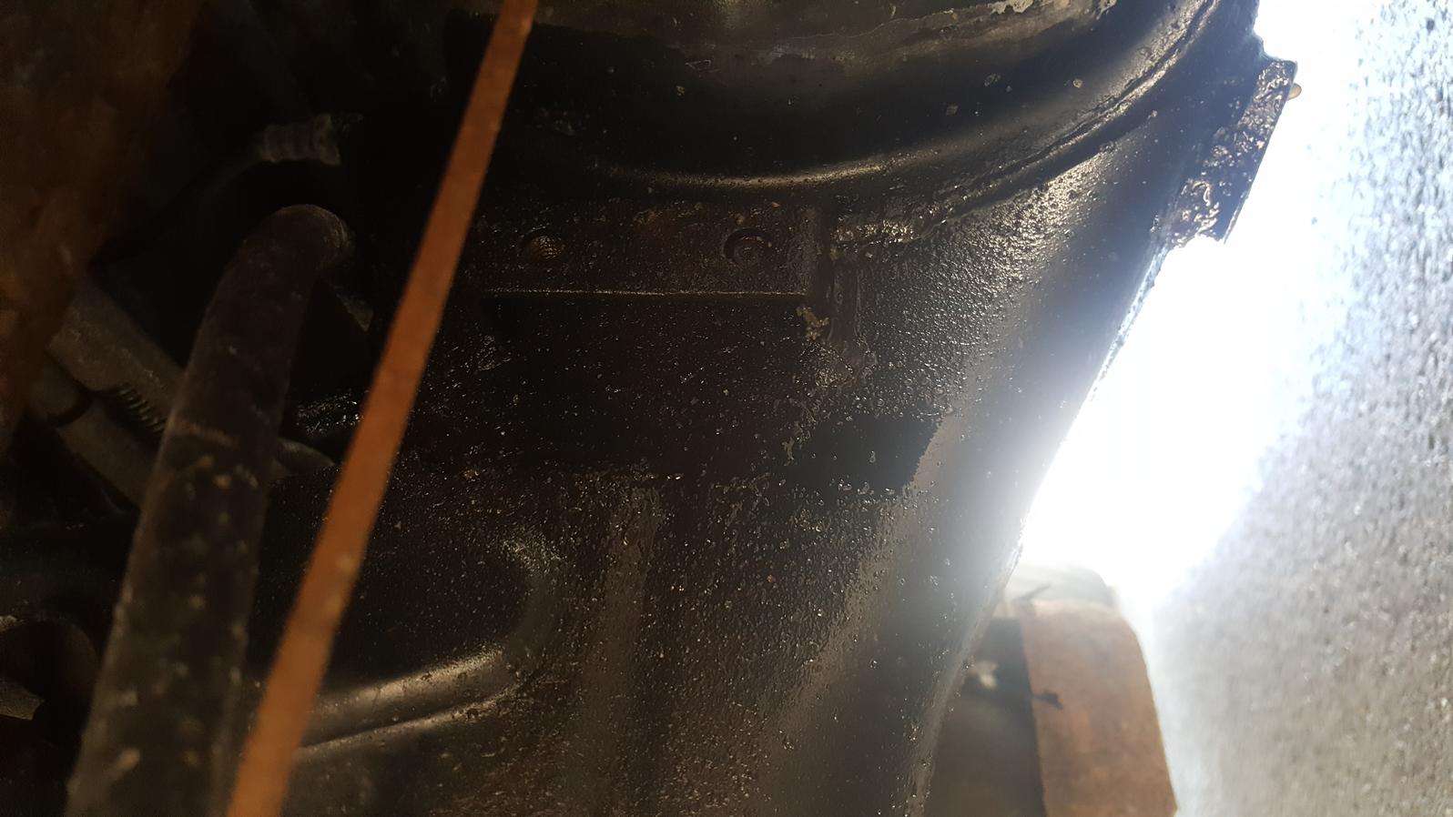

So i went and tried to grab a picture of the leakage at lunch time. The picture is tough but you can see the fluid has been running from the breather down the left of the pumpkin for some time.

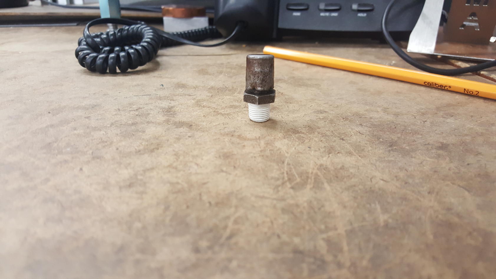

I removed the breather and cleaned it out. It is moving freely without hesitation, I even blew some air and feel it coming out. still not ruling out the fact that the internals could have an issue.
I decieded to add some teflon tape to the threads to help prevent any leaks. If the diff is overfilled it will continue to leak until its at a happy level. I will monitor it.
