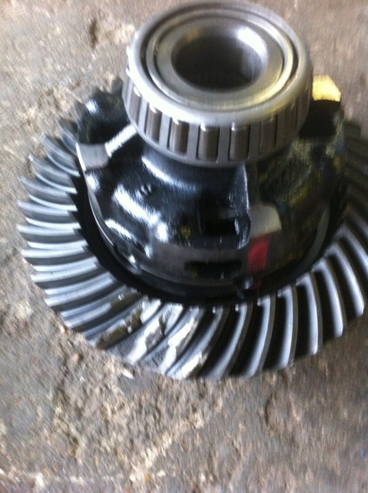

So the guy that I turned the runner into took the entire driveshaft out including the gears. And he saw something he'd never saw before. This is an independent guy not Toyota. He said looking at the damage, it appears to be a fault by toyota. Here is a picture.

So now we are trying to find a new differential as a whole, because not only are the gears broken but the bearings are worn. So it'll be best to just replace the entire differential then repairing it. Problem is....there is no 2wd differential i can find with 3.71 gears.
just keeping you guys updated. Just ordered oem guts of the diff which includes the ring pinion and everything in between. Got it from a local stealership for a price of $1550! Very costly part. Should be in Monday, and I'll keep posted on how it drives after its fitted with new guts.
