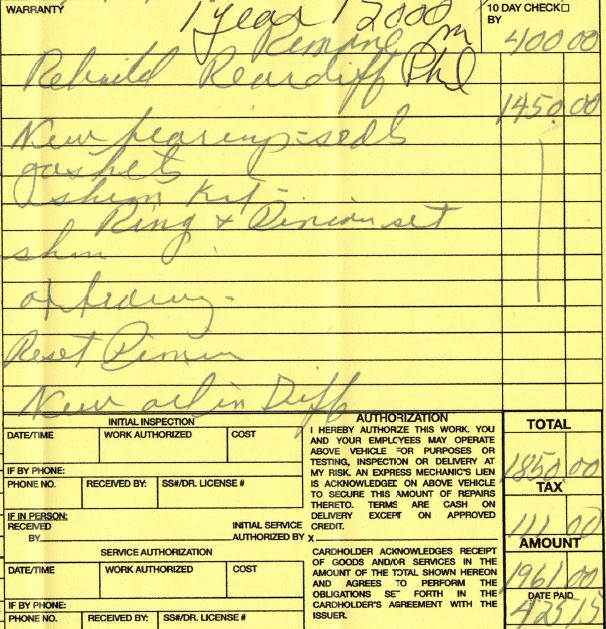

I have a 2007 4Runner SR5 4.0L with 101k miles. I bought the vehicle used in 2009 with 40k. For almost two years, prior to May 2015, I had a gradual increase in whining coming from the rear. The whining noise seemed directly proportional to vehicle speed and got louder and louder over time. It got so bad the passengers in the rear seat could not hear conversation coming from the front. Riding with friends on vacation at the Finger Lakes in July 2014 was almost painful. In April, 2015, I took my vehicle to my trusted mechanic who put it on the lift and ruled out other problems like wheel bearings. He does not do rears so he suggested a transmission shop that he trusted. I took it to the transmission shop and and the recommended I replace the rear at 97k miles. I was without the vehicle for about 10 days or 6 business days. Got my 4Runner back on 4/25/15. As I mentioned earlier, the vehicle purred. Not a sound. Cost for the job was $1850 plus 6% PA sales tax equaled $1961. My interpretation of the itemized description follows. Image snippet of the receipt is attached.
*Remove and rebuild rear differential
*New bearings-seals, gaskets
*Shim kit, ring and pinion set
*Shim
*Something I can’t read...
*Reset Pinion
*New oil in diff
About a month later, I noticed a small drip, took it back to the shop. The shop fixed at no charge. The mechanic said that one of the factory gaskets was very thin. They reapplied the gasket with some silicone. Leak stopped. Fast forward to November and I am starting to notice a faint whining. I will admit, I live in SE PA and it is now getting colder. During the summer, I love to ride with all the windows, sunroof and rear window down. Road noise could have prevented me from hearing the noise return earlier in the summer. I am now riding with the windows up that blocks out the road noise.

If you're concerned, take it back to the shop. Express your concern, ask them to listen to it with you. Even if they don't think it's a problem now, you'll still have documented that the sound existed before your warranty expired, just in case it gets worse later.
Exactly as Kid said. If there is a problem coming from an area that they worked on and is warrantied. Take it back and get it documented.
Yes keep pressing them, I know from experience, I'm on my THIRD rear diff at only 80k miles. Keep in mind those miles are easy highway miles on a stock truck with impeccable maintanence from day one. Seems like these rear diffs are weak and puny and aren't quite tough enough for something as heavy as a 4th gen. Mine was silent for six months or so after the install of the new one the first time around and then developed a slight whine at speed, so I had to press them (Toyota) to replace it again as they "had a hard time hearing the problem," but in the end they swapped it and all is well.
When they opened it up again for the second time it was cooked again, so I'm glad I pursued the issue until it got fixed free of charge.
Yes take it back in. For what they charged you (which is obscene, in my opinion), insist that it's 100%.
Also, I don't believe the ambient temperature is a factor.
Did you do the break in procedure. A then change the diff oil.
I did by the book. Drove it home on the back roads easily, then let is sit. Then I continued to drive it easily for another 500 miles, changed the oil with a quality syn 75w90 and motored on, but it still died.
