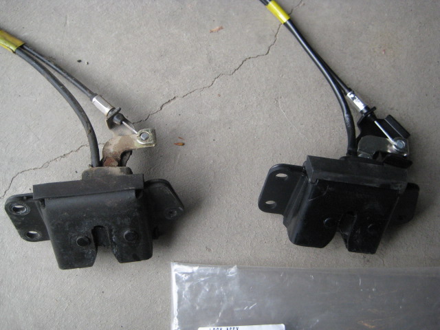

again, i've been having the same problems. it seems like the latch mechanism was causing all the troubles. i replaced it today with a new one and now ALL of the moving parts in the tailgate, including the outside handle, are working smoothly. when i pulled out the old latch assembly it was corroded and full of dust and the lube had long since dried out. email me at [email protected] if you want instructions and photos on how to take apart the tailgate. it's pretty easy.

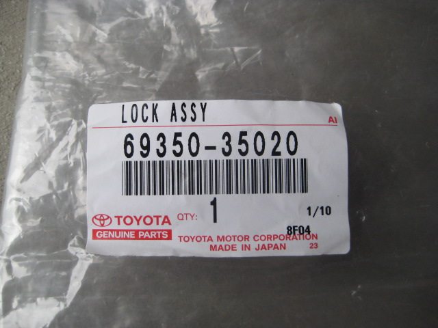

you wouldnt happen to know the part # would you??
sure. it's 69350-35020. i ordered mine from toyotapartsbarn.com for $93.18 plus $12.11 for shipping. seemed to be the best price i could find via google last week.
