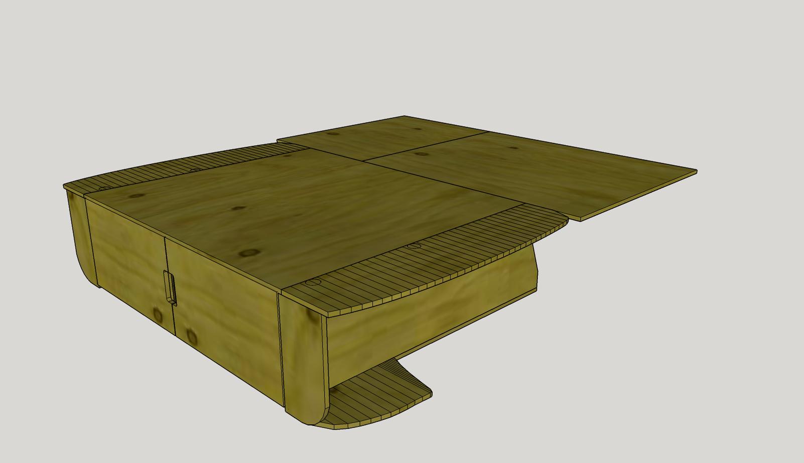

1) What is supporting the wings? Are there vertical supports somewhere?
It looks like you have a front panel in your plans, but I didn't see one in the picture you posted (I'm guessing it was just temporarily moved at the time?)
The wings (parts that fill in the sides between the top of the box sides of the 4Runner) are fully supported by a 1"x1"x35" hardwood cleat attached to the side of the box. There is another standoff cut to fit the top curve of the Wheel well on the bottom of each wing keep it flat and level. The support cleats also serve as very nice handles when removing the unit.
You can see a couple of circles on the wings in the Sketchup renderings where I had intended to use Euro hinges like in the Original plans. But I decided that I did not want the wings attached. so Now I can just lift them up and get at what ever is stored inside.

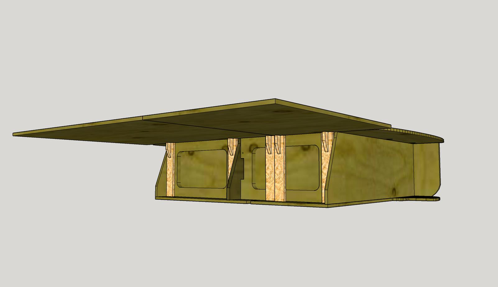

Regarding the front panel, It's there, but I cut 2 big rectangular holes in it to lose about 2 lbs and give me more access when tightening screwing the screws for the drawer slides. The box is ~36" deep and there would have been no way to mount the slides after gluing up the box w/o the holes in the front panel. You can see the holes in this rendering and if you look closely in some of the pics of the sleeping platform.
